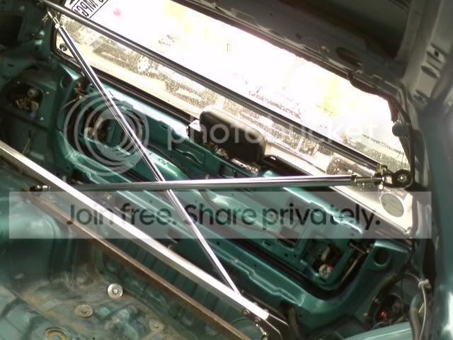

or get creative and make something yourself for 8th the price......don't invest on that crap.......
my set up cost 50 bucks.......the X should help w/flex since it mounts at diaganal points....on that bar bove they all mount on the same axis and how would they avoid flex? I can see that only has a fancy c pillar w/extra looks....

^ ^ how did you bolt both the cpillar bar and the diagonal bars to one bolt hole (either seat belt hole)

i mean how did you bolt both bars to one hole..you bolted the cpillar bar to the seat belt hole, then what did you bolt the other bar to

the x bars are bolted to the c pillar bar joints (same bolts are used)......and the c pillar bar connects to the seatbelt holes as normal across the top...
what I did was tighten both x bars as tight as I could.....then the c pillar.......then the x bars again......and then the c pillar till both bars could not be turned....locked the nots DONE!!!
