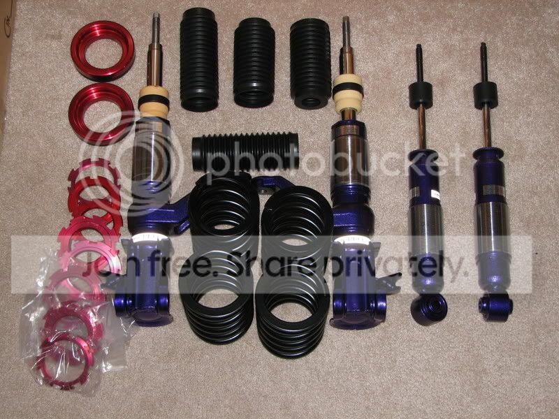

Alright so here is the problem. In the rear I put everything that was on the top part of the stock strut on this one. Well everytime I hit a bump the shock does what I would say is seperates from the top mount. I took a picture and the pink color is the gap after I went over a bump. How big of a bump? My durb to my driveway The black part that the red arrow is pointing to stays in place and the rest of the strut moves upward. It happens if I stand in the trunk and jump up and down Also attached is a picture of all the parts that came with it. Maybe I am missing something??
Was I supposed to put this part in the the coilover set up any place?
If so where? I just looked at the stock rear shocks and I have these left over but the directions from tanabe do not say anything about this piece.

nope that was what I forgot. It was allowing the rubber boot to slide onto the strut shaft. Thanks!
