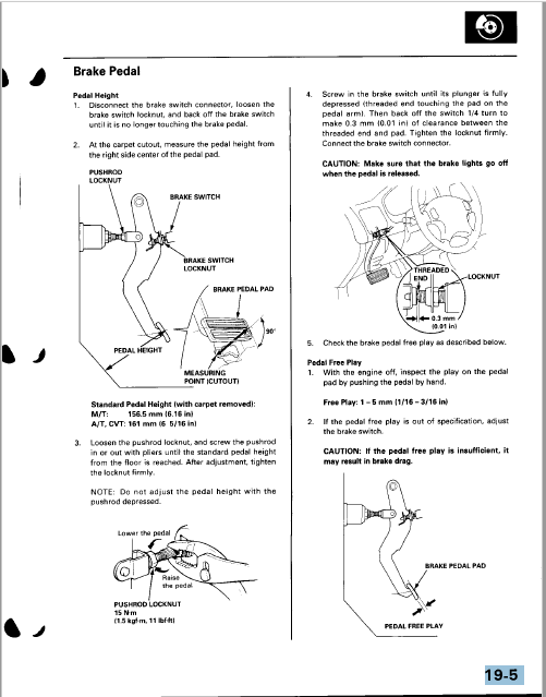

Old Oct 31, 2017 | 08:50 AM
Tyson's Avatar
Joined: Apr 2002
Posts: 18,961
Likes: 76
From: I am Tyson
Default Re: Break issue
thats not it.
