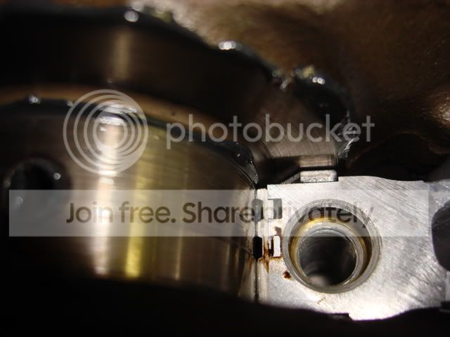

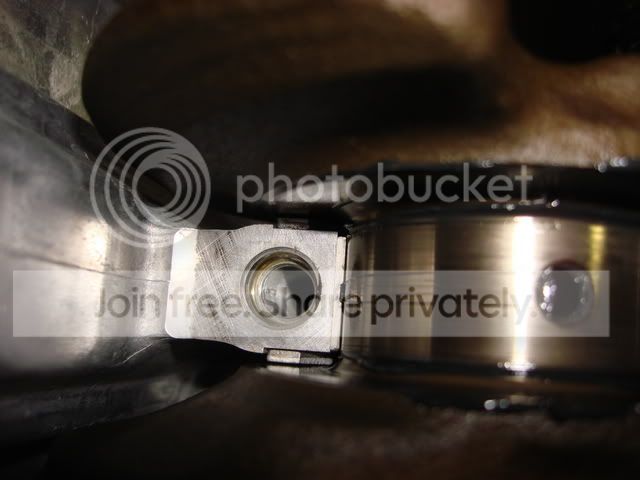

I am rebuilding my first motor. Just a stock B18b. I had the block, and crank checked and cleaned up by a machine shop. Everything checked out fine. I installed the Main bearings, and thrust washers (crank of course) last night. I used all OEM bearings, and torqued down to spec in 2 stages 22ft lb, then 56ft lb and in the correct order.
Probably a really silly question, but are the thrust washers supposed to move around? Like rotating with the crank a little bit. I can hear it stop at the main cap. Just making sure it is normal before I continue. TIA

Let me explain a little better. They are not rotating 360 deg around with crank. They rotate up until they hit the main cap.

One side is flush
Other is just under
Factory OEM HONDA part #13014-PR3-S20

That is a nasty crank. Nice job getting it polished and cleaned. With that work your TW's are the last of your problems.

I think the streaks are just oil; they correspond to the tangs and oiling grooves on the bearings.

Default Re: (Honda Tool)
looks normal to me

Default Re: (DonF)
<TABLE WIDTH="90%" CELLSPACING=0 CELLPADDING=0 ALIGN=CENTER><TR><TD>Quote, originally posted by DonF &raquo;</TD></TR><TR><TD CLASS="quote">That is a nasty crank. Nice job getting it polished and cleaned. With that work your TW's are the last of your problems.</TD></TR></TABLE>
It is assembly lube. Thanks for answering the question...

Hmm, that might be an ingenious design not to have it flush. Wonder why folks? :rhetorical tone:

When torqueing down the main cap, you will not distort the trust bearing if it's made to come up a bit short?

<TABLE WIDTH="90%" CELLSPACING=0 CELLPADDING=0 ALIGN=CENTER><TR><TD>Quote, originally posted by Pondus &raquo;</TD></TR><TR><TD CLASS="quote">When torqueing down the main cap, you will not distort the trust bearing if it's made to come up a bit short?</TD></TR></TABLE>
Correct!!
