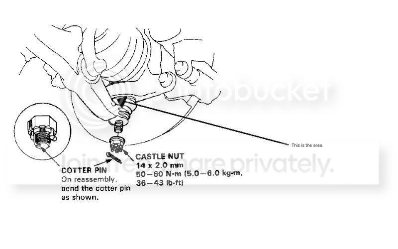

Hey, I got all the bolts off that I need to take out but I can't separate this dang LCA from the ball joint. I rented the pitchfork set from pepboys and tried that but no luck.
Anyone else have a different way of doing this?

im not from the states... so bear with me...
a pitchfork is something like this?
anyway... i use that... clamp it on very tight... then slam on the side of your control arm with a hammer... i should come loose... can be a bitch though..
