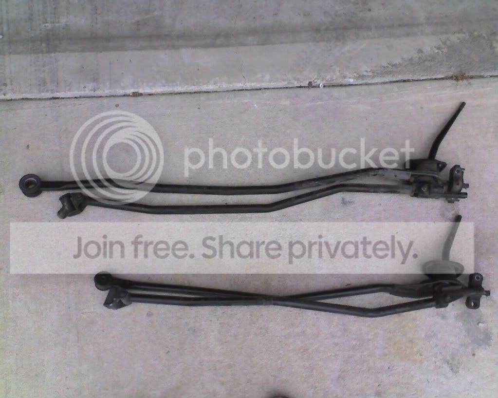

ya haha i agree a pic coming up right now

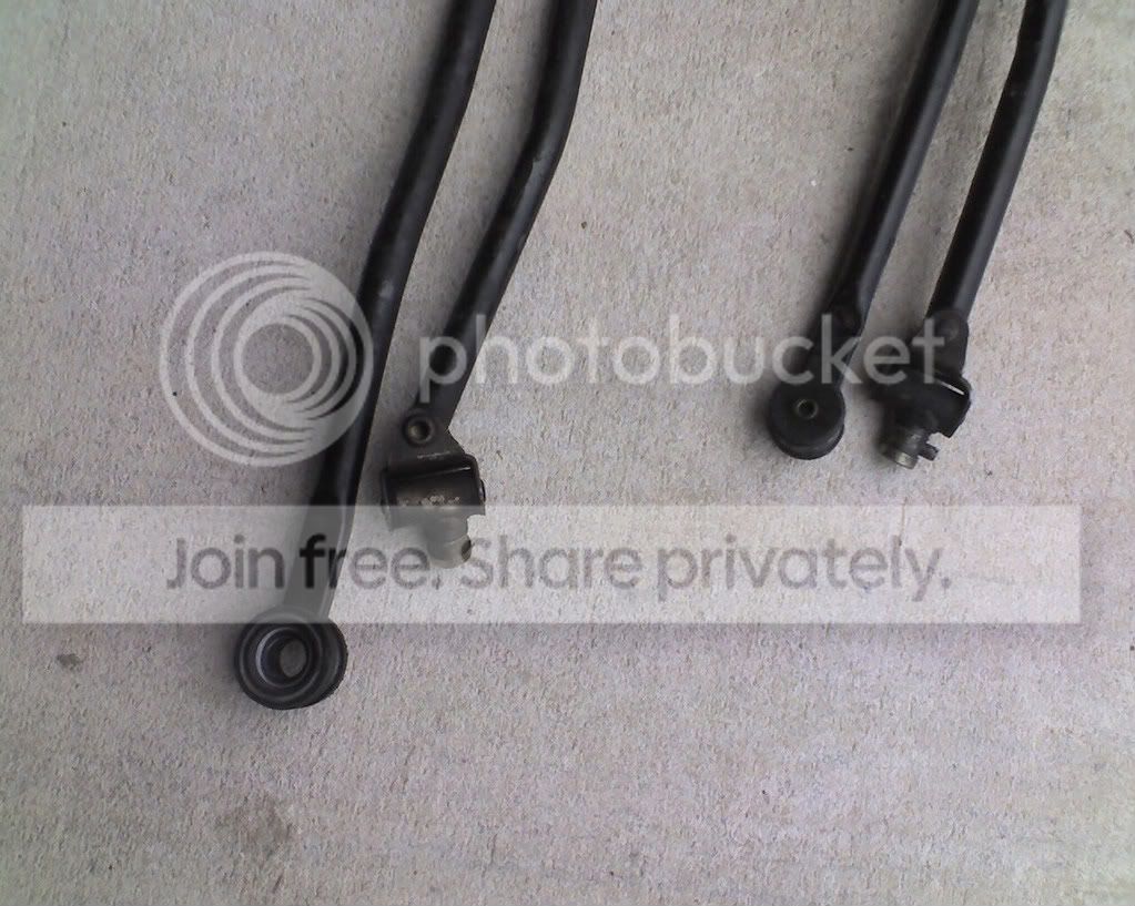

Old May 13, 2008 | 04:10 PM
nomoshing's Avatar
Posts: 343
thing is waaay far away
anyone know for sure if its from an EF?

i think u may have a b-series linkage, could also be from an EF like u said.i have both laying around sumwhere ill get bakk to u on it.

Old May 13, 2008 | 10:49 PM
eg_boi's Avatar
Posts: 213
Default Re: (nomoshing)
that's a b series shift linkage. you can tell by where the 12 bolt is suppose to go through.
couldnt find a pix of the d series from yahoo so here's one from ebay. this is how a d series shift linkage is.
http://cgi.ebay.com/ebaymotors...ZWDVW
notice that part where the 12 nut is suppose to go through..

b-series on left and ef on right
b link on top, ef on bottom

nomoshing's Avatar
Posts: 343
Default Re: (MoreBoost!)
exactly what i needed
