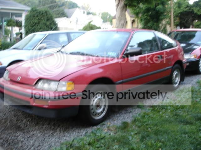

Yes its a work in progress and cost me only 600 bucks. So Now I need to figure out how to repair that rear quarter panel rust and when you open the driver side door on the bottom(not the door but the inside) there is a good size rust hole. I was kinda thinking about sandblasting the whole body to see where all the rust is. Now i would cut and weld in other crx pieces but crx's are VERY VERY hard to come by here and dont think I could get those rear quarter panel parts. Are there any ways to just stop the rust and weld in a filler plate and then bondo over it without the rust coming back?

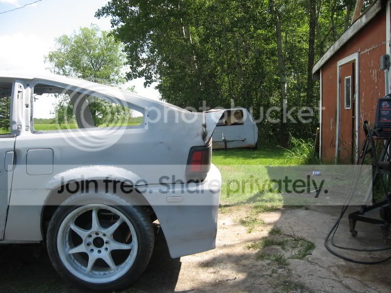

holy yellow drums batman
looks damn good too me allso bondo skrinks ,so id give it the last coat and then wait to give it the finish sanding a few days at least
kinda reminds me of my crx lol (i have alot of welding ahead of me )
you cans ee in this pic all the area that need to be finished up
