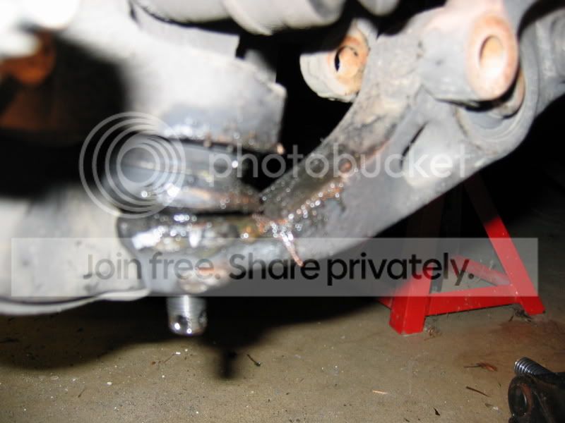

I've been trying to use the crobar to pop it off but nothing is working still.... It really seems like its impossible, maybe this picture can help.. theres greese from the torn boot from me wedging away at trying to pop the sucker off.

o man, u fucked it up dude. I've used the ratchet method all the time and it's worked perfectly all the time.
