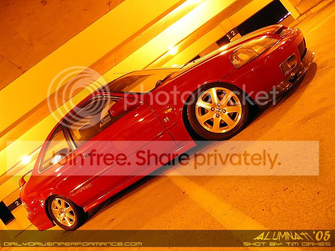

But for now, here's pics of my EM1 for views
