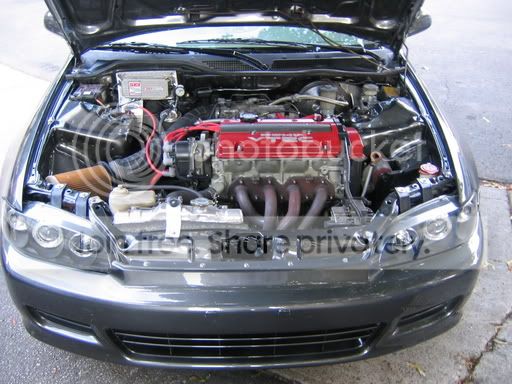

Here's what mine currently looks like but add the battery back in the front which is why you see that ugly tray (for track tech inspection reasons!)!

thanks alot. that pic was before the wire tuck, abs gotta come out.

</TD></TR></TABLE>thanks alot. that pic was before the wire tuck, abs gotta come out.
