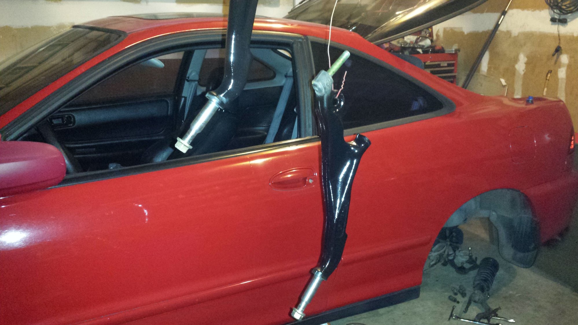

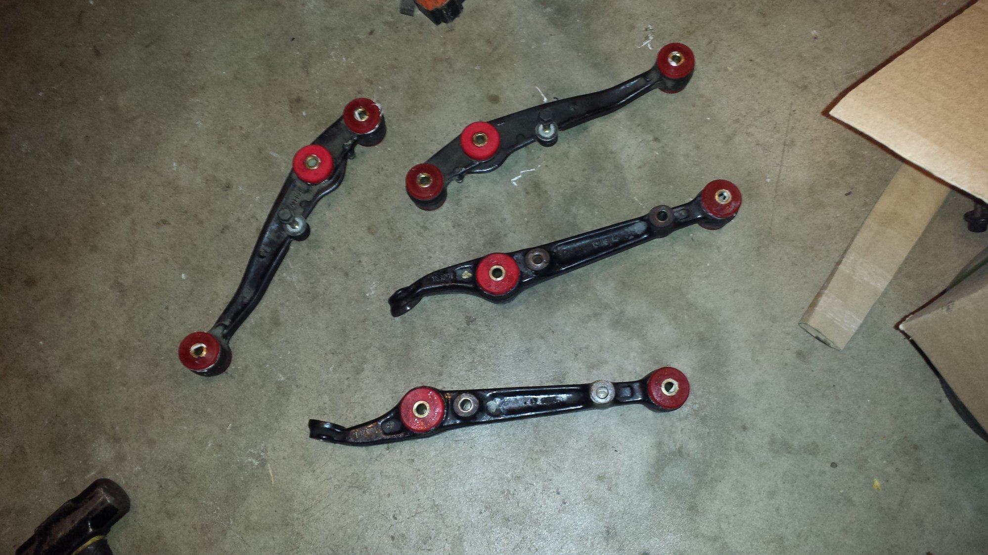

weather warmed up so i managed to get some stuff done. a forum member here hooked me up and helped me press out and install new poly bushings. these are probably the only ones i will replace as the others are still in good condition and are kind of a bitch to press out. a big props to him!
scored a nice set of cloth seats on craigslist. i normally would hold off on this kind of stuff until later but the price was too good to pass up and they are in great condition.

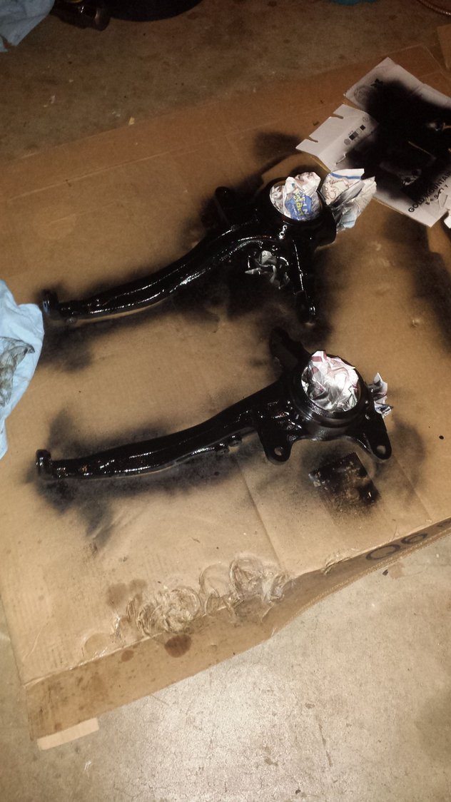

had the local garage press out the bearings and ball joints on the front knuckles so i could get them wire wheeled and painted. i think i might be going with longer wheel studs. not 100% sure though
painting the lower control arms.
prepping the brake calipers/brackets for paint. luckily there is no rust on these things but alot of brake dust and dirt. if this car was from up north they'd be totally trashed. i also noticed the mid pipe had some rust on it..i wire wheeled the rear portion down (and removing the anti-corrosion tin plating in the process) and repainted it with some glossy paint. not sure how this will hold off rust but i dont really plan on driving this car in the winter anyways. i am going to stick with the OEM exhaust for the time being and maybe do a cat delete as it is in superb condition regarding the flanges and bolts.
