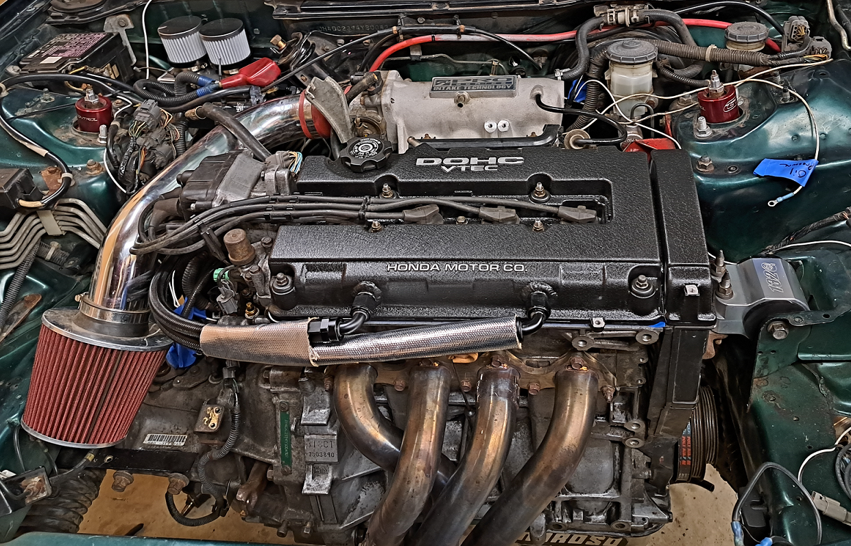

Obligatory regional championship winning engine bay shot:

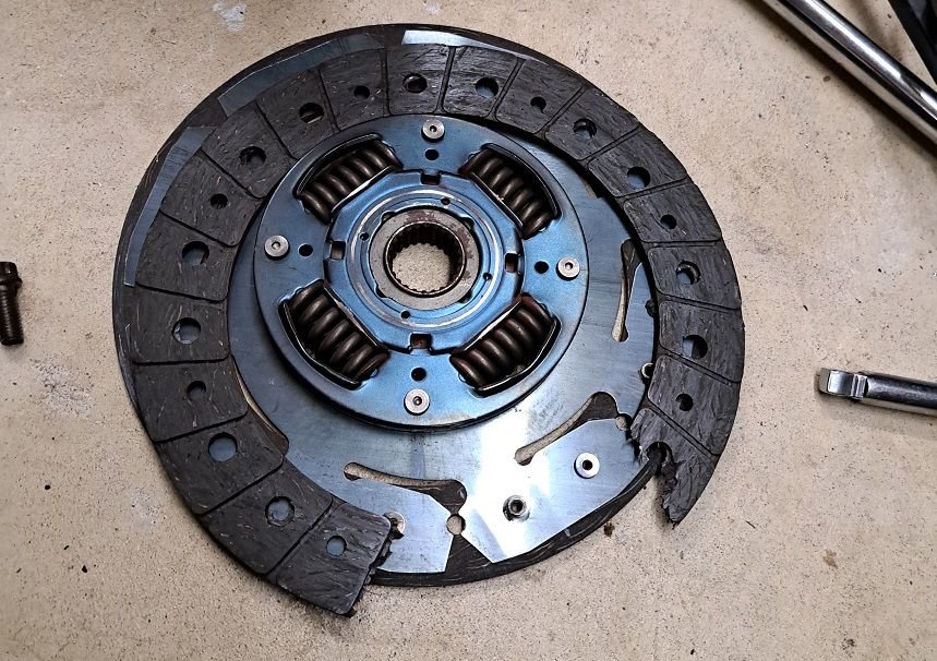

Oh and my guess of a spring from the clutch disk was not correct in how it failed. But it was the friction disk that let me down. And it looks like it took the pressure plate with it. Or maybe it was the other way around? There had been a grinding noise while the clutch pedal was depressed for more than half the season which I incorrectly attributed to the release bearing and so I ignored it.

the clutch issues has been pretty common in the honda paddock. someone has this (or a spring) issue every year. I ran an exedy stock replacement setup for many years... between the B18B, B20s, and the C5... no issues. but it was only a matter of time i think.

I've lost a clutch disk spring on this car before, nice to know it's got multiple failure modes. New stuff is from ACT which worked well enough on my 240.

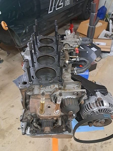

Well I've been slacking on updates here. Most updates are done on IG reels mostly to force me to put time into the car most nights of the week after I get my kid to sleep.
The engine is back together and looking fresh, although I'm going to take another swing at the oil pan gasket when it gets in since I think I used too much RTV and I'm afraid of it coming off and being sucked into the oil pickup. The head also now sports adjustable cam gears and Crower branded type-R cams because the rules said it's ok. Hopefully they're not ground backwards like one horror story I've heard about. The valve cover has some additional AN fittings for a catch can setup I'll run next year and some relief areas for the adjustable cam gears. It also got powder coated black, and looks much nicer.
I had a number of the exhaust bolt holes on the head given thread inserts. I also had new to me valve springs / retainers installed with new valve seals as well. The hope is that this will buy me an extra 300rpm or so. If I'm lucky this means saving a shift or two around VIR.

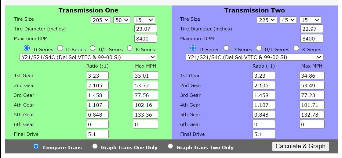

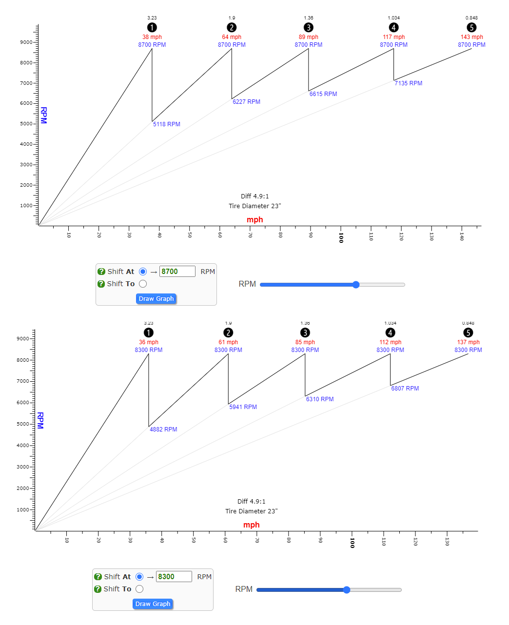

the way I see it, a shift costs you a half second of throttle application, often more for us mortals. So the question becomes how baddly do I need that next gear?

woohoo progress!!! you are better off than i am. If people dont know, Steve and I race together... and I'm hoping we can both help each other out in 2023 to get faster. That being said, let me jump into what i see vs. what i did in my old car (my new car is a completely different animal for shifting)
I think you are on a GSR trans with an LS 5th (maybe)... if my math is right. I believe you need to be on a 5.1 and change your 5th, you are giving up 1-2 seconds at VIR alone by not having the 5.1. I believed 143mph was attainable in my new car and i was VERY wrong. You want to be at the top of 5th gear entering the braking zone on the back straight at VIR... i promise. 132-133mph is the goal.
I ran this setup in the old car... i didnt hide it. it was a "stock" B16 gear set (no super short 5th) with a 5.1... and it was a rocketship (unlike my new car). The best i got was a 2:14 at VIR (i think) but my potential was in the 12s.
Above is the reference point for my shifting. the car made a peak of 189.X (under 189.5) HP and came in consistently at 2515lbs. It did have a beat up front end and the aero on the front made it suffer IMHO.... my actual top speed was only in the 127mph range in the old car and i think it had to do with learning to take oak tree better AND the beat up front end. Another note... it would do the same MPH on the front and the back straight at VIR... and 125 at Summit Point. You will notice my shift points are earlier due to my aggressive gearing but it does translate into a couple of MPH difference at every point on the track... seeking your terminal velocity ASAP in a B series car works (as yet to be determined in the K powered 6 speed). Also note: my 5th gear had no rev limiter.
some of the biggest difference i see at summit point... i'm shifting while still turning as i exit T1, I HAVE to go to 5th gear just before i crest the hill exiting T3, and i purposely short shift the car going for turn 7 to rotate the car and get the car ramping up to smooth out T8 and T9 to go flat... I also needed 5th gear between 9 and 10, and i use the downshift to scrub speed for T10 but end up shifting back to 5th well before the start stand, usually at pit out/the EV shack.
VIR is BIG on MPH... obviously.... TONS of time left on the table if your gears arent just right.
the 5.1FD going up the uphill esses is out of control fast. I actually used to reel in Baker going up the esses... and then he would abuse me for the rest of the track lol
My VIR takeaways... i short shift the flat esses into 4th so i dont burn the tires down. but with the shorter gears i also shift into 5th about 100 yards before the bridge. I use the top of 4th to go through south bend and then shift again to 5th to keep accelerating... oak tree is one slow brake, not a double brake (we can get into the data). I'm concerned about the Hog Pen entry for you with this gearing... i run up to the top of 4th and pop the limiter at the right side curbinig, i turn in and brake on the left hand gators and throttle out. It seems with your gearing things will be slow to pull you out.

Also, after a lot more effort than I think is reasonable, the engine / trans are in the car. Glad I still had the stock mounts to buy me the extra clearance I needed, and glad I sill had the passenger side torque mount I made last year to keep it from twisting too much. Now to get it running again and get it to a frame machine.
