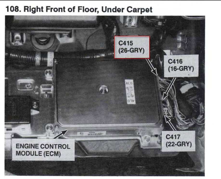

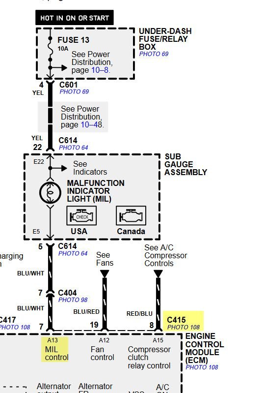

The wire coming from A13 at the ECU is the MIL light. I just can't remember if it is power or ground, so I am unsure what the other wire on your bulb would need to go to.

the ECU provides ground, the other side of the light needs to be connected to battery.
OP, it's a simple light, even a 12v LED works fine. It can be mounted anywhere you have available, next to a switch for the service jumper ideally.

Dammit….should have mentioned this earlier but just remembered I have an ECU from a 1993 prelude. Same engine family so I would assume the pin outs should be the same.

1993 Prelude is also at pin A13.
