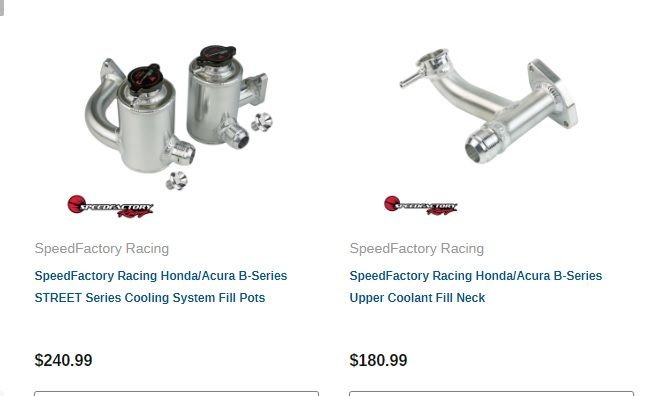

Hey all,
I have a tucked radiator on my 91 Civic STD that I will be using for track days and autocross. When I built it, I just put an inline filler in the upper coolant hose. I am looking at the two options below to replace it. what benefits would there be to spending a little extra on the one with the fill pot? Does anyone have first hand experience with either of these? Engine is B16a3. Thanks!

Let me re-phrase that then- its a scirocco sized dual pass aluminum radiator without the provision for a cap

No bueno? should I spend the money on a DA rad instead of messing with filler necks and pots??

okay if this is the case... i personally would go with the swirl pot because it should eliminate the need to use the funnel system to burp.
