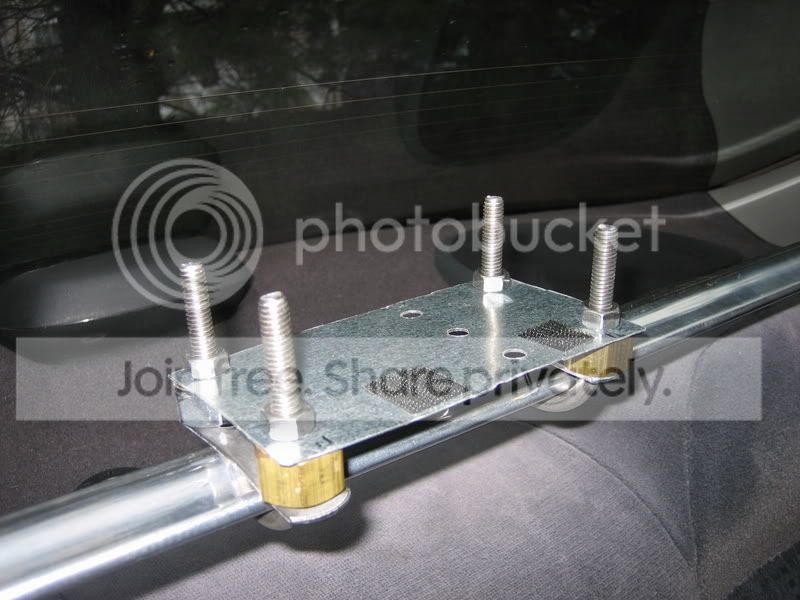

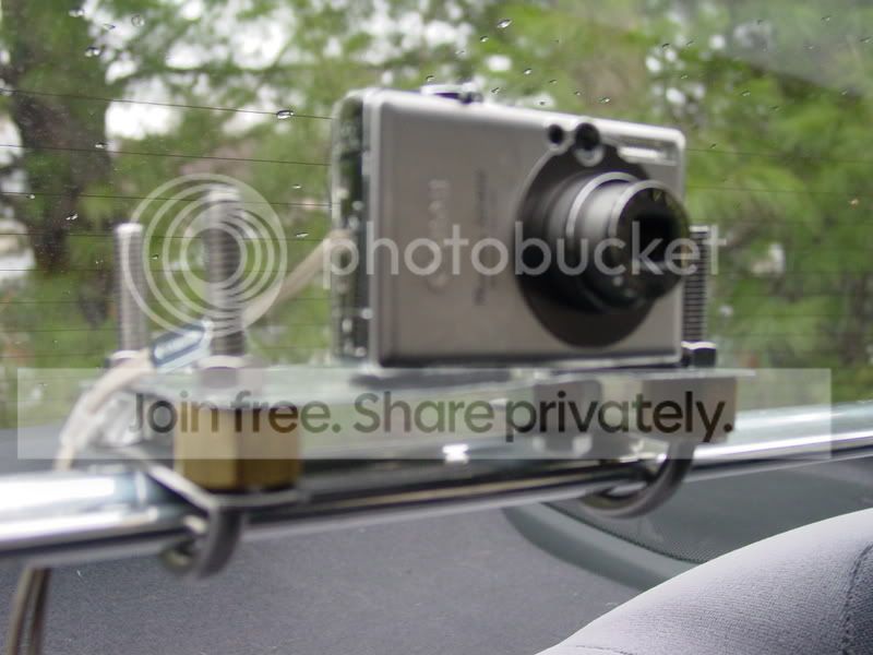

i made one the other day, here a couple pics
used 2 U-clamps and cut a little bit of sheet metal. doesn't look all that fancy but it works perfectly. i tested it through some twisty roads and such and held the camera perfectly still. the 2 little black patches u see on the sheet metal are velcro, used it for added security for the camera and it keeps from the sheet metal vibrating against the camera. all together it cost me less than $10 and didn't take long to make... i still gota find a strap/rope that i can strap around the camera and bar for that 2nd security measure.
if anyone knows if this would be legal to use at an auto-x event leme kno. got a race this weekend and would love to get in-car video

I don't see why it wouldn't be autocross legal. As long as it doesn't move around, it should pass tech. I've seen people running much more ghetto stuff than that.
I got my wife an SD630 for Xmas... maybe I should make one of those mounts too and borrow it for auto-x...

The view will be better the closer you can get to the windshield. Unless you like to see the back of your head

the mount does sit a bit far back but thats what zoom is for. i tested it thru some twisty back roads and the view is great. quality of audio and video is actually pretty good too.

Just to throw this out there, if we're talking about TRACK use, not autox, very few instructors will be ok with the headrest-mounted variety. I sure won't be.

Yep, or that shaft sticking someone, both in the event of an off-track excursion/crash. Some are, a lot aren't. Ultimately, it'll be his call. If you're going to take the time and effort to do it, might as well do it more right.

how so? may not look all that great but i kno for sure the mount or camera wont come off. i've pushed on it, shook the bar, even drove thru some bumpy a$$ twisty roads and it didnt budge. camptured very steady and smooth video the entire time. only way i see it coming off is if the whole c-pillar bar comes off, in which ill have much bigger worries lol. i trust it just as much, if not more, than some of the ones companies sell. ill prolly just use it for a couple races and eventually get a sticky pod

I'm never more worried about something than a thing that will A.) skewer me, or B.) hit me in the head. Those things have the potential to do both, IMO. If you want to use it, that's your call. I just won't ride shotgun with it.

ya thats a good point
in hindsight i wouldnt have used it (at the trackday)
it is a hollow ended bar at head level with a pretty heavy object on it
