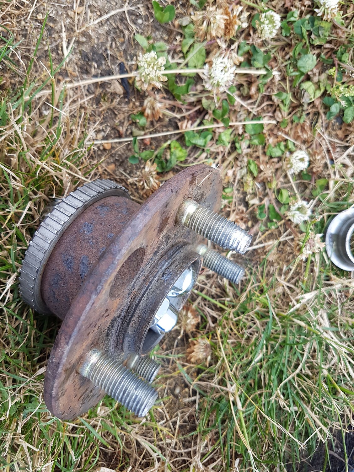

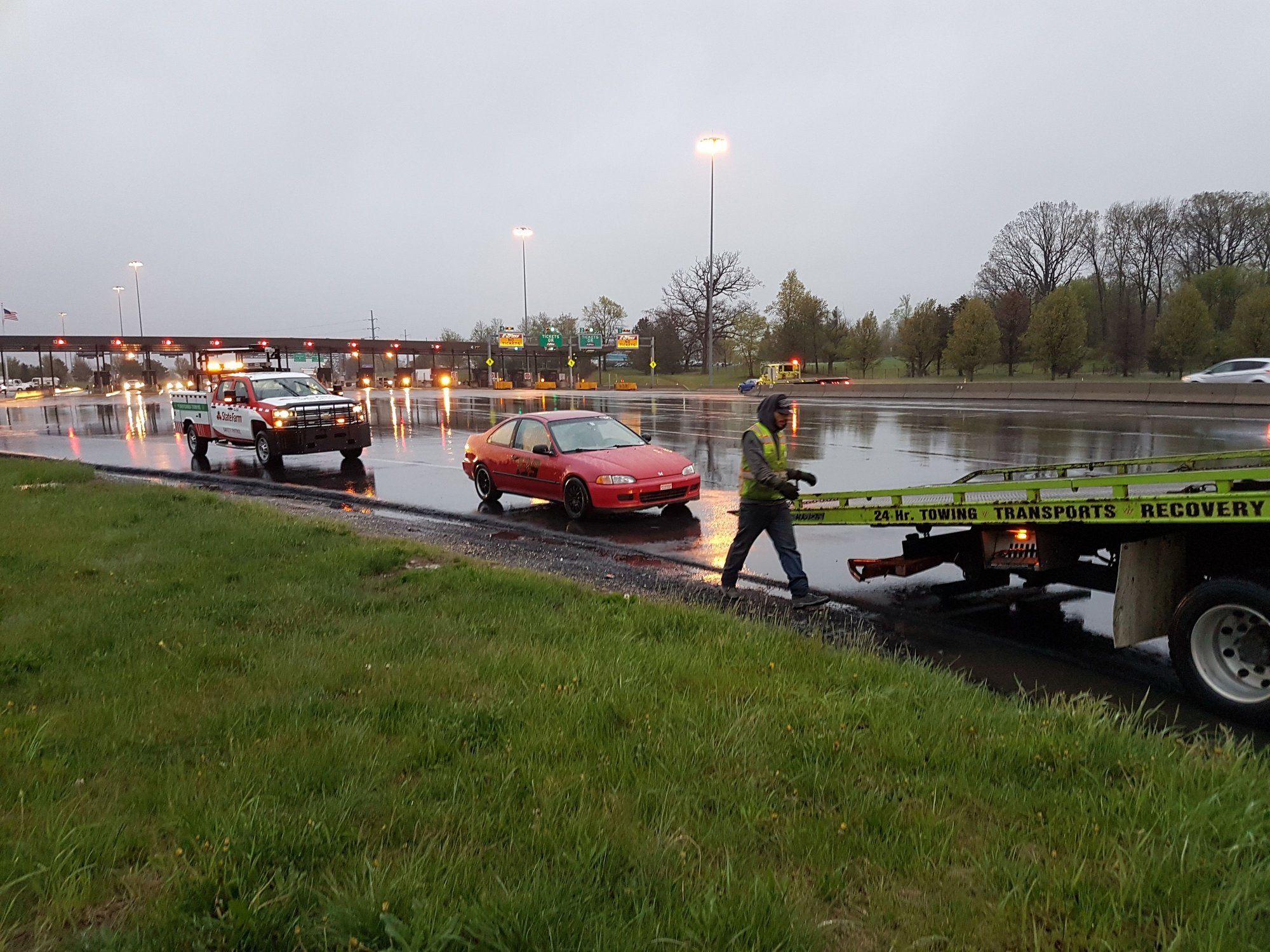

And after lunch, when I was coming back to the track, I felt the car pulling weirdly. I discovered that my NT-05s were corded up front and my alignment was out ~ 7/16 up front (toe out).
I tried to fix the alignment to drive it home, but the problem persisted.
Knowing that the tires were corded and ran on the previous alignment, I figured the issue was related to the tire wear from the previous alignment, and I decided to drive it home on the cords. I made it ~200 miles before rain happened and then I had to get a tow home.
I was 60 miles and it cost me over 230 dollars.

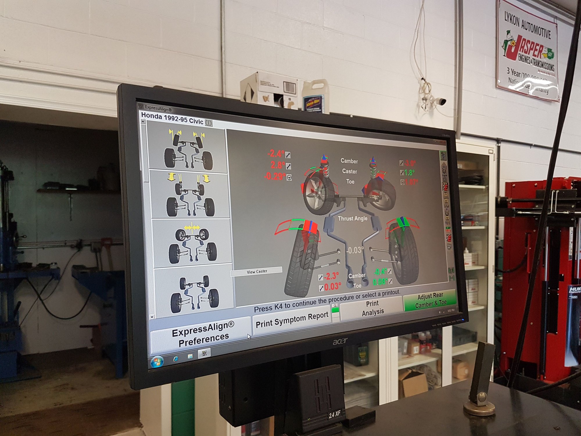

2.) Getting a real alignment for my Civic that a seasoned instructor couldn't drive without spinning at Lightning

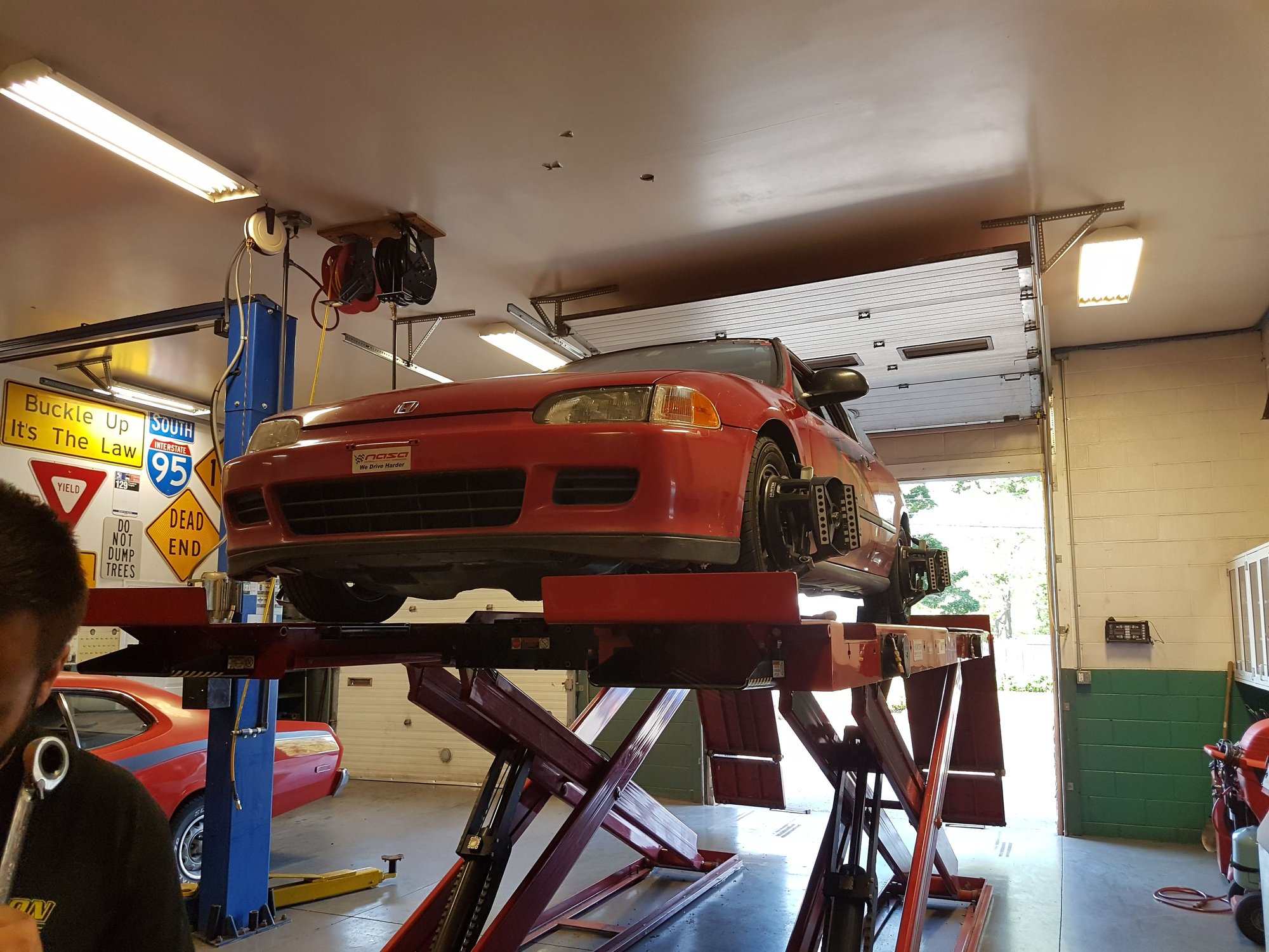

So, based on previous experience with 200 TW tires, I decided to get -3 deg. of camber up front with -1.5 deg. of camber in the rear with zero toe all around. I bought some cheap eBay camber arms for the front UCAs to replace the ones I damaged on my way to the Glen, clocked the bushings relative to what the OEM ones had, then I drove over to Lykon Automotive in Bristol, PA for an alignment with Tyler-- the Service Manager there.
As you can see, the alignment was pretty out of whack on the Civic. Note this was AFTER I installed new camber arms-- so it's not exactly what it was at the Glen, but you get the picture...
So we got the car on the rack and started making adjustments. Tyler was able to get it dialed in easily, and I used bags of gravel to simulate my own weight in the driver seat.
With the car off the rack, I headed to Texas Roadhouse with a couple of friends and my girlfriend for some cinammon-buttered bread and some steak. My friend also had a surprise for me-- my new tires:

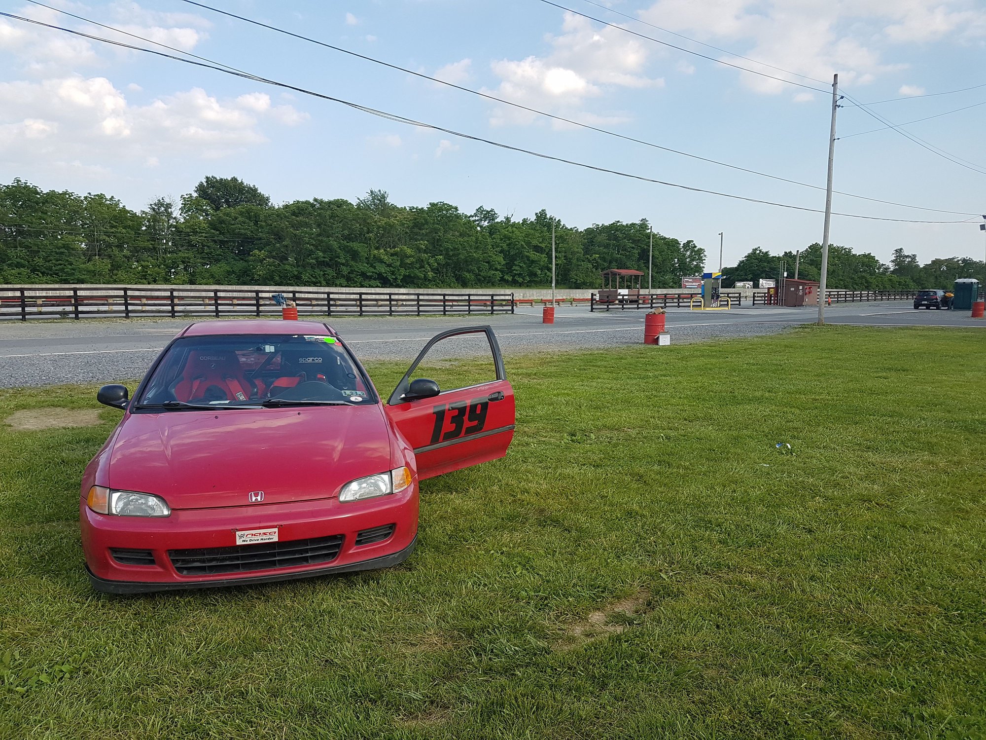

I had five friends who originally wanted to go to Summit with me, but slowly they started to hand in their resignations and eventually it was just me driving four hours to WV. Luckily I was blessed with a beautiful and trouble-free drive down.
Once I got there I set up camp and made some friends to hang out with since I was bored. We had a couple of beers and eventually hit the sack.
I woke up to the race organizers singing over the PA system as they usually do at Summit Point with NASA MA. I got tech'd, set my car up, and got ready to hit the track.
Around the paddock, there were both really extreme cars and very basic cars. For example, a TT Ferrari and a completely stock Corolla were seen in paddock. It's that kind of diversity you can expect at NASA events.

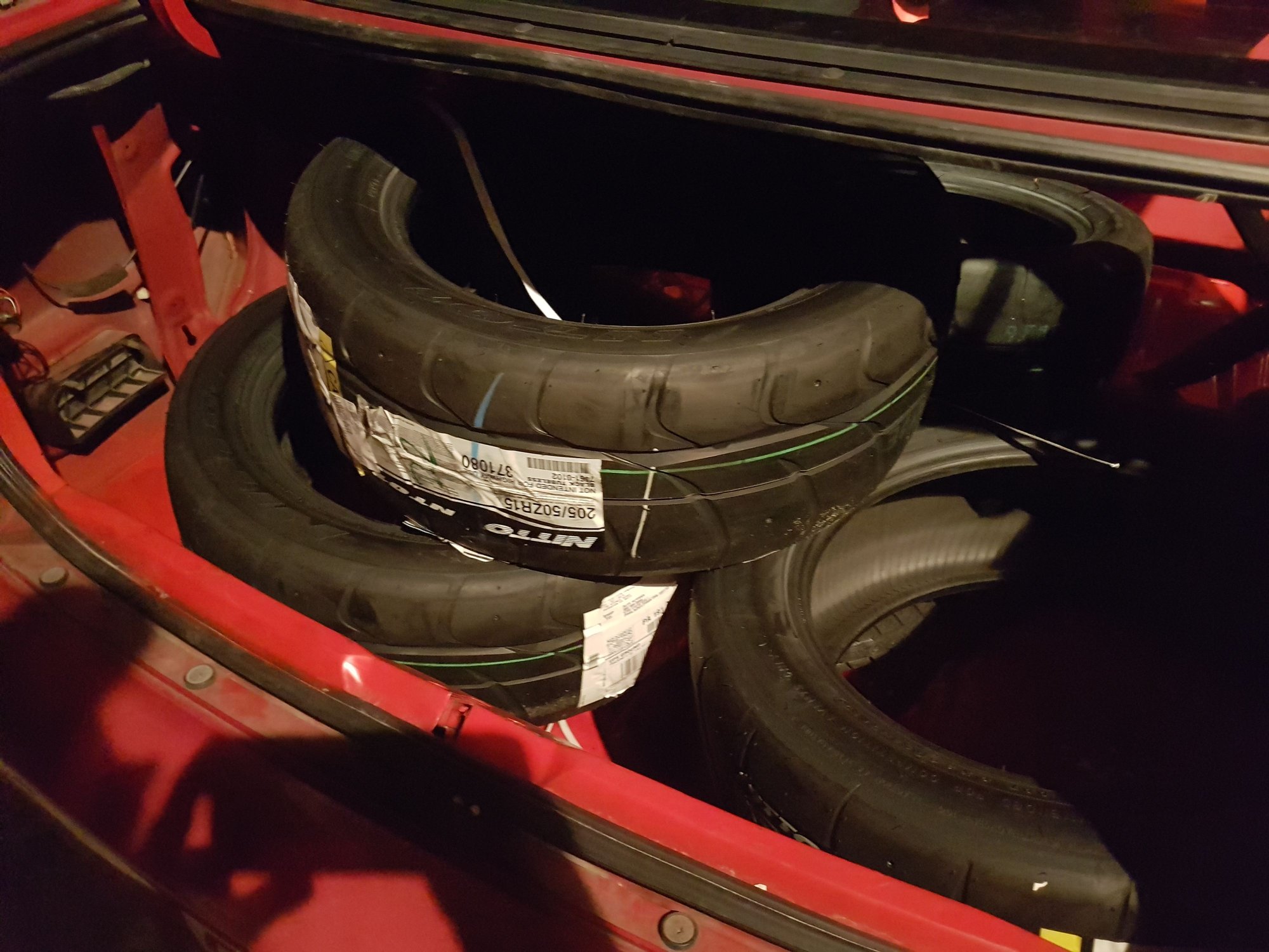

The first day for me was spent getting used to my new tires. I spent about an hour at one point going over data only to figure out that I just needed to brake less. I shortly after spoke with an instructor about what I was doing on track and he immediately told me exactly what I discovered over the course of an hour, but he told me in a matter of seconds.

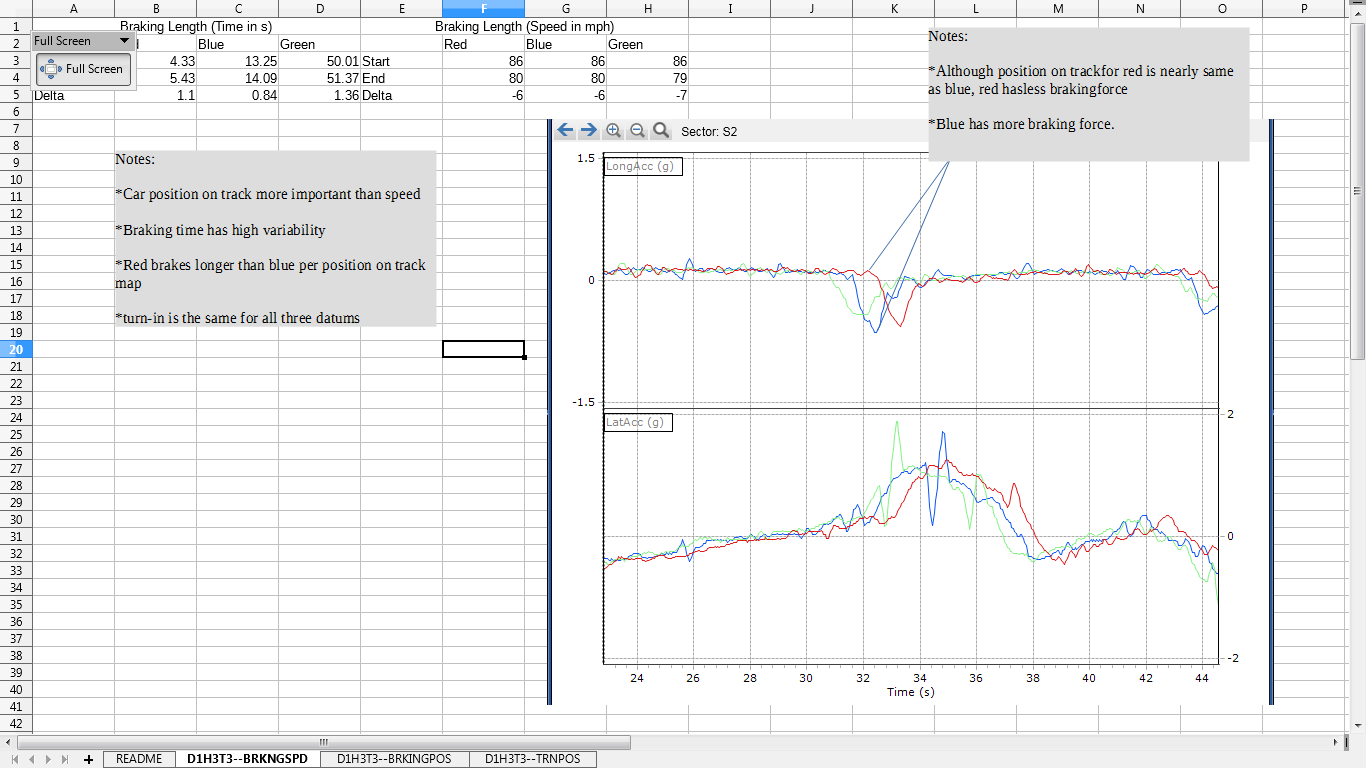

Lesson learned: instructor first, data second.
After the first day, NASA MA always has a HUGE barbecue and celebration for the winners of the races throughout the day. My new friends and I had some more beers and some great food and shortly after got together at our campsite to talk about the racing during the day and how we could improve our times.
On the second day I actually brought an instructor with me and was able to get a best time of 1:34.5. I was also able to experiment with my lines.
For example, I discovered that I could go flat through the chute until the middle of the curbing, at which point I lifted and got right on the brakes. It was a little sketchy, but at least I know I can do it now.
At the end of the day, I was one of the last people to leave the track because it's very hard to load my tires and all my tools in this car. However, the car was running-- so that's a win.
Also, WV is very hot in June. Hot enough for me to take my shirt off. The sunglasses over my perscription glasses are from my girlfriend. I still don't have sunglasses...

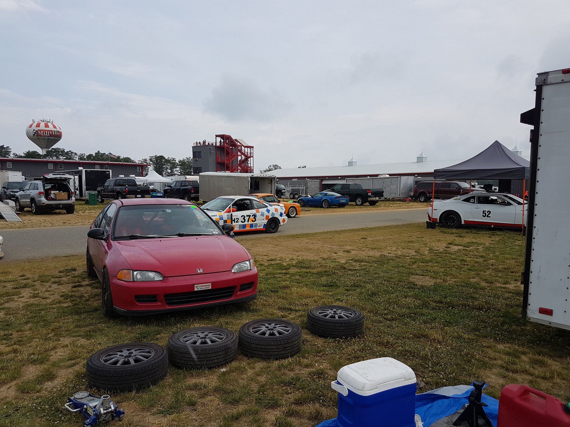

For NJMP Thunder, when I got there I set up camp in the morning (cuz I didn't stay over night) and my friends all wished me a happy belated birthday. After going through registration and tech, I tried to change my wheels-- but my stud had snapped in the rear, so I was left to do a hub change before my first heat. It took me about thirty minutes to get the car in the air take the wheel off, replace the hub, put the new hub on, and put the wheel back on. Note that I had a spare hub with me (I got lucky).
During my first day I spun in T4 at Thunder. It was a scary moment but I was able to avoid the tire walls on the inside of five, so it was a win for me. I also had to spend some time getting used to the NT01s. The car is much faster with these R comps as I'm able to keep up with very fast cars in the corners, but as you all know my car is very slow due to the stock motor. As a result it still does get blown away in the straights. Note however that I was able to get significantly more point-bys with the better tires.
The first day was kind of frustrating overall, however. There were a lot of aggressive drivers and people hesitant to give point-bys which is not common for NASA in DE3. You can see me riding some guy's butt trying to get a point-by because he wouldn't give me one.
NASA NE also has barbecues after their first Saturday to celebrate wins by the racers. During that time we hung out and had a good time throwing back some brewskis and making jokes and telling stories about our track-time for the day.
During the second day I did a side-by-side drill with my friend Jeff in the white Civic with the blue stripes and I did multiple sessions playing cat-and-mouse with my buddy Ken in his Integra with a stock motor.
I spun again in T4 trying to lift at the 3 marker and get back on the gas at the 1 marker as well during day 2. I could have tried to save it and I could probably make it through that corner with the same speed if I used more inside curbing, but it's not worth it for DE.
The fastest time I was able to secure at NJMP Thunder without the chicane was a 1:43.5. I definitely have about 0.5 seconds left in the car by using more curbing on the inside of T1 through T5, but other than that my instructor told me I was maxing out the car.

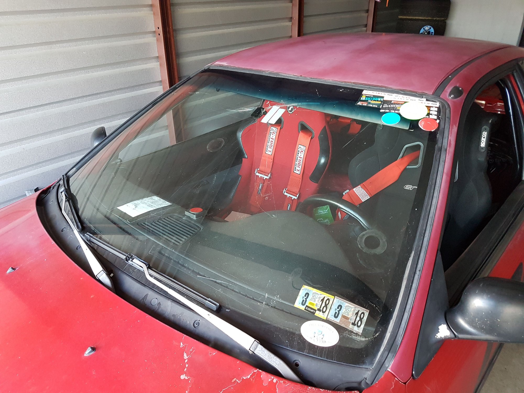

I cracked my windshield a while back trying to install my Wink Mirror as you can see in this thread. I know I could most likely get through the season with this, but with a lapse in driving events, I decided it would be good to fix this and also some rust on the top of my roof due to the previous owner sealing the windshield to the roof with silicone.
So I took my car to TConnor Customs in Bristol, PA for a great price and I am currently awaiting a full fix of the roof and windshield. I'll update you guys when it's fully finished! Until then, thanks for reading.
