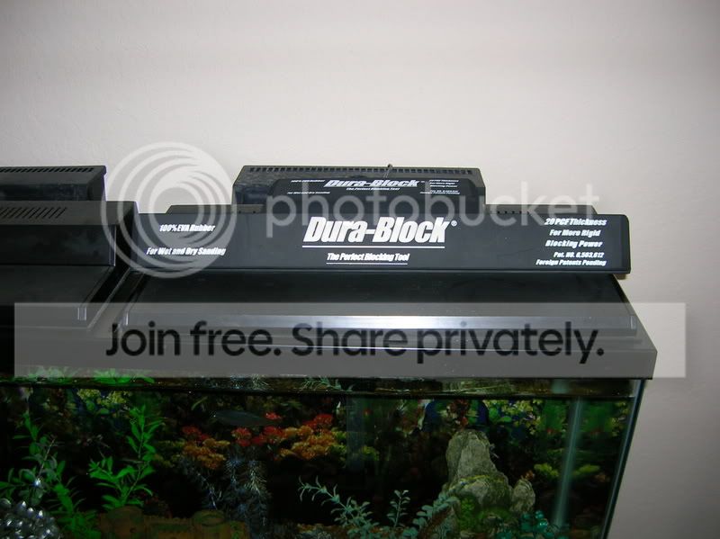

Im finishing my doors today. Here is what I am using.
Bottom one is 24"

<TABLE WIDTH="90%" CELLSPACING=0 CELLPADDING=0 ALIGN=CENTER><TR><TD>Quote, originally posted by SneezinCD5 &raquo;</TD></TR><TR><TD CLASS="quote">Im finishing my doors today. Here is what I am using.
Bottom one is 24"
where do you buy sandpaper for your 24" block? wheres the best place to order something like those dura-blocks?
Old May 7, 2007 | 10:03 AM
turbob18si's Avatar
Posts: 2,386
From: on the street, WA-OR-CA
Default Re: waves in doors (dinko)
I have those same dura blocks and I buy self adhesive sandpaper in rolls at the local auto body store the same place that sold me the blocks. If you dont have a store like that check out http://www.eastwoodco.com/
