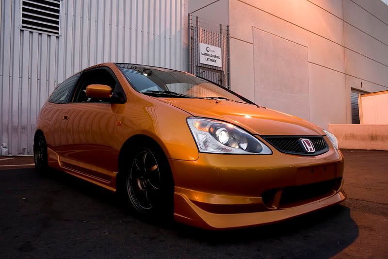

that is a tri-color paint job!!! here is a pic of my old ep3 color is imola orange which is a tri-color also.
a close up one.
here is a color of it when the sun is setting. in the bright light the color is brighter and in the shade the color is darker

that is not the same color as the mustang stitch. and just so ya know, any three stage paint can be mixed as a base/clear. instead of adding the midcoat pearl, they just add it to the base with a pearl effect. Now it does not look exactly the same since the midcoat does add much more effect than mixing it in the base , but just because it is a 3 stage paint from the factory or the formula calls for a midcoat, does not mean that it was sprayed that way, alot of shops will use the basecoat formula instead of spending more money and time spraying the midcoat(production shops mostly). just thought you may want to know that for future reference. your civic does not really look like a true 3 stage base/pearl/clear. looks like a pearlbase/clear but im sure pictures dont do the car justice

I totally agree with him, the EP3 looks like base/clear. It doesn't have the flop that a tri-coat paintjob does. I shoot tri-coats and the pearl effect is a lot more intense.

i know my color is not the same but what you have to really looks is the curve of the body. look at the mustang where it curves it a brighter color. if my ep3 had more curves to it it would be the same effect.

here is more pics of my car. if my car was in a showroom with lightings it would be the same as the mustang.
