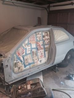

So Ive come to the part of my project that I want to make sure I do everything perfect. So here we go. ive stripped car and did body work after scuffing entire car with 220. And block sanded filler with same grit. Next applied PPG eopxy primer which we use at work on helicopters. Block sanded with 220. Next layer I used Eastwood Primer surfacer. Block sanded with 400. Sooooooo Now the next and most critical step. Ive already purchased a new DeVILBISS paint gun and SPI clearcoat. Still indecisive on the paint color brand and color. Toss up between midori and thunder grey. Doesnt matter just what paints does anyone recommend. Not going with OMNI. Want something higher quality but not HOK. And this will be an autocross/weekend car. Garage kept. Any suggestions? Ill be making a homemade paintbooth with fans to create a positive pressure booth. Big question for the experts. After laying down the basecoat, do I wait an hour or two then shoot the clear or do I sand when dry, apply another coat of base, then shoot my multiple layers of clear? Once the clear is complete what grit do I sand with? Basically would like a thorough walk through on the next and final steps to this already lengthy body project that I was not expecting. Thanks Honda-tech!

The paint isn't as important as the clear. A cheaper paint will take more material for coverage. If you are painting gray then you probably don't need the best since you already primered gray. If you are painting a gray / silver with metallic then you need to know how to spray it and make sure its sprayed correctly or else you'll get what looks like tiger stripes. Basically before you shoot just wet your floor and walls to prevent any dirt from coming up. Spray first coat all around the car then do the second coat, etc. use as many coats as needed until you cover all the areas with paint and are happy with the results. Maybe about 3-4 coats. as you go feel the paint bc if you don't mix the paint correct with reducer then it won't look good. If you feel and it feels like sandpaper then you didn't put enough reducer. If you spray and it looks to watery then you added too much reducer. If you have a show car baby that is your life then you can sand down the paint like an hour after you finish spraying it with like a 1000-2000 grit to flatten it out. If you decide to bypass this step which most every painter does then apply the clear coat about 30 -45 minutes after depending on how cold it is in your garage. Just make sure the paint is dry but not TOO dry. If painting a whole car you can almost get away with just clear coating right after painting since it takes about that time to spray around the car. If you do wait too long then you will need to sand the base coat. So base coating a car is the easy part. Clear coating is what takes the real talent. You need to make sure your PSI is right to not get ALOT of orange peel. You should actually practice clear coating before doing the car. After you clear coat let the car sit overnight, more if freezing weather. Depending on how the clear coat came out determines the grit sand paper you would use. If it is thick as hell then you might need a 1200 grit to cut a lot of it off, working your way up to 3000. If you're a good painter then you won't have a lot of peel and should be able to just use 3000. Then use compound and buff that SOB. This will take many hours to. If you never painted there is high risk you will F it up with it either being really orange peely or drips which might have you repainting.
Old Nov 21, 2015 | 08:56 PM
gorillafart's Avatar
Joined: Feb 2008
Posts: 1,466
Default Re: Painting help
just going to piggyback off of paintnship's response, and re-iterate as well as reply in my own words:
find a paint brand that is the best quality you can afford in your price range. if you're looking for suggestions, PPG, Sikkens, sherwin williams AWX, comes to mind. Always do your best to stick to one paint company from primer to clearcoat.
you dont need to sand the basecoat if you're spraying wet on wet. meaning you spray a coat, let it flash (typically 10-15 minutes depending on your ambient temperature) then spray the 2nd coat (sometimes 3rd coat if needed). and if you're happy with the coverage you've gotten, let the basecoat flash for another 20-30mins (again, depending on your ambient temperature) then spray clearcoat.
Typically basecoats tend to have around a 24hour window in which you can basically spray the clearcoat. only after that window has closed would you need to sand the basecoat. if its a solvent basecoat, wetsand it. if the basecoat is a waterbase basecoat Drysand it then wipe clean and respray a layer of basecoat, then spray clearcoat. try not to wait this long to spray clear. because u dont want to sand basecoat if you can avoid it. you'll almost definitely end up with sanding particles that will show up in your clear.
after you've finished and your paintjob is all dried which could take any amount of time really depending on the type of reducer/hardener/activator you used. some can air dry in 4 hours some take 24 hours. and your ambient temperature will affect drying times as well. but after its dry, depending on how well you sprayed, you could wetsand the clearcoat with 1000grit followed by 2000, move to cutt and buff with a buffer.
get a spray out card from the auto paint store, so you can do a test run of the paint. you spray X amount of coats till the paint card is covered to the desired coverage, and clear it. that will give you an idea of how your paint will look on the car. if i were you i'd go out and find a used fender, and practice on that first.

thanks for the responese. Ive painted before. I work in aviation. But dont have a controlled area. And the paints we use are french based. Some are epoxy primers some a single stage. But the helicopter paint we use is Dupont IMron700. I cant for the life of me figure out how to apply without fisheyes. Every other paint I use is fine. Could be Im using low lint cloths and no tack cloth. I was looking at tcp global restoration shop paint. Read decent reviews. This car will be garage kept and only see track with a little weekend warrior. The tcp paint has no activator. It only gets reduced, sooooo a little hazy on that brand. The spi clear gets mixed 1:1 and the guy said I could use a reducer but doesnt recommend it. My main questions are basically answered. I read and now told by you guys to apply the clear on the wet base. Guess helps adhere the two together. I think Im going thunder grey with metallic. So can you explain these tigerstripes I need to watch out for? Ive read about them but havent seen much about preventive measures on them. Thanks honda-tech

That tiger stripe effect happens different ways. Can happen if you spray too close, too much reducer in paint. They sell special reducers which you should ask your paint shop about. They have different strengths available depending on your temperature. You should see in the paint if you are leaving stripes in the paint if you look in detail. It helps if you let the 2nd to last coat dry very well (maybe 20-30 mins) and then apply the final coat at about 10 inch distance to erase any stripes you might have.
