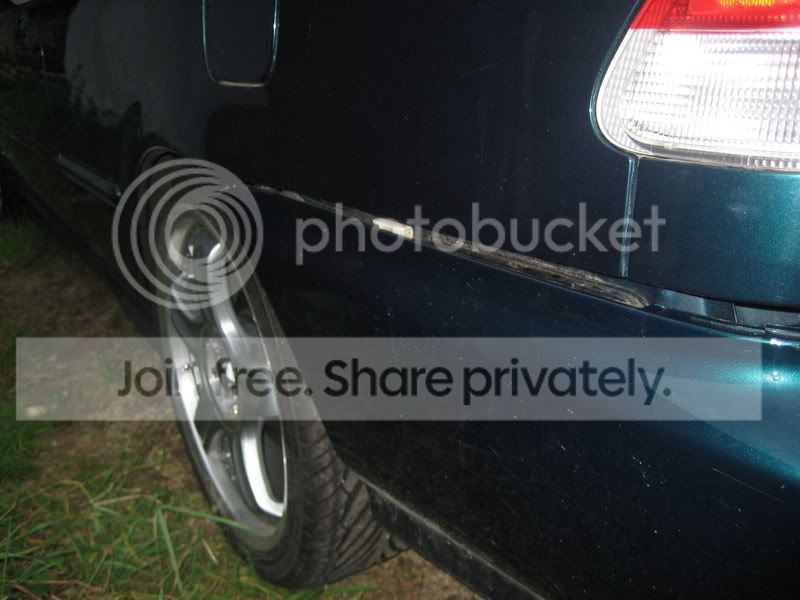

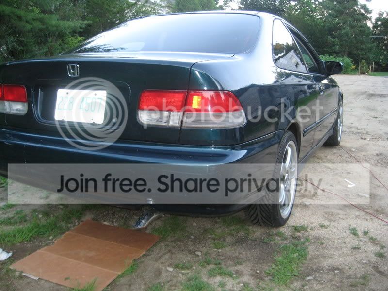

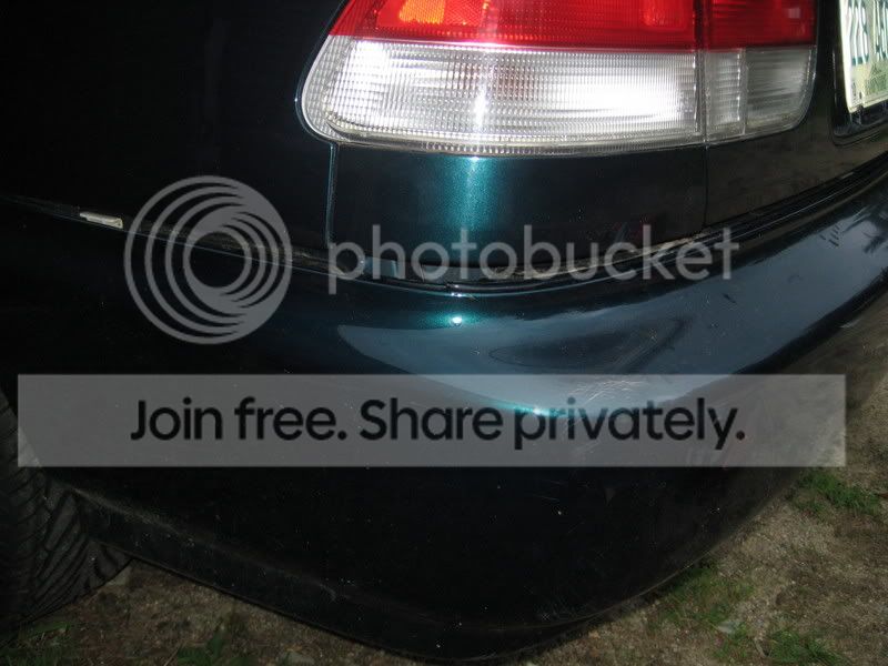

my bumper got hit out of place...
was wondering if its an easy fix. should i try to take off my bumper and bend somthing into place? ive never taken off my bumper so i really dont have any idea but i wanna get it fixed without having to get a new one. it looks like crap.
heres some pics
any help would be awsome thanks.

its not the hardware bro. See that white clip...the bumpers needs to rest inside there so all you gotta do it take out the screw on the side that goes into the fender, and put the bumper back into that lil white clip.
Old Jul 20, 2007 | 12:48 PM
jofatts187's Avatar
Posts: 33
From: Nashua, NH, US
so basicly those 2 screws on each side of the bumper, then force it up... ive tryed forcing it up without taking the screws but ill try taking them out. thanks

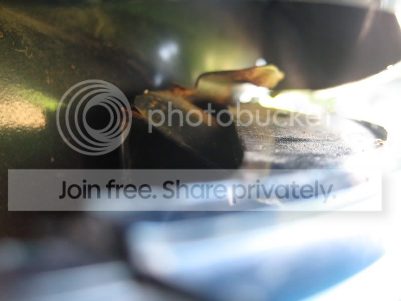

hey heres another picture
im not sure if the clips are suposed to go on the bottom to hold the bumper up.. makes sence that way.
please let me know thanks people.

i dont understand that pic
Old Jul 22, 2007 | 12:11 PM
jofatts187's Avatar
Posts: 33
thats the bumper under the clips and the pic was taken right under my taillight.... just really close up to the clips
