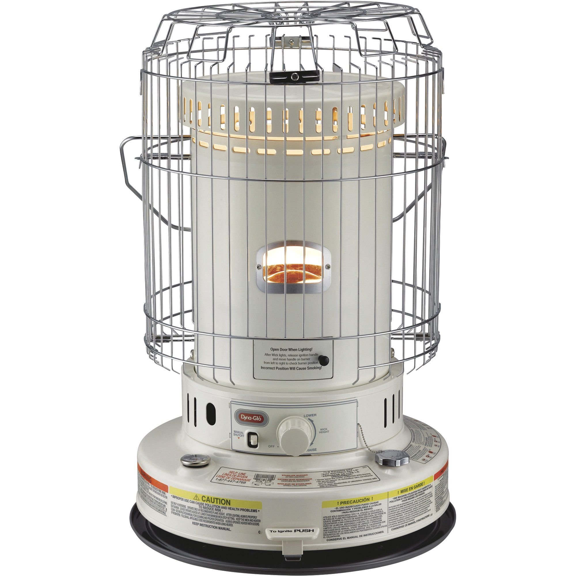

So, i painted some extra parts i had this weekend in my home made "booth" in my garage and i was really pleased with the results. I'm going to attempt the whole car now. My question is related to drying/curing and air temps. I plan on painting this car next week or week after, so far the temps are holding steady in the mid 70s for most of the day but they do drop at night to mid 50s. Would it be a good idea to introduce some heat in my detached garage when the temperatures drop in the evenings? I have 2 kerosene heaters i can place in the garage with the car and the car parts while they are drying (obviously wont be in the garage during painting). I wasn' sure if this could potentially cause a reaction of some kind with the paint on the car by basically introducing fumes in to the garage. Any DIY'ers try this or any tips from the pros?

What kind of paint and how will your booth be set up? I see no problem with the heater, unless its like the ones like a jet engine. indirect heat will be ideal

The paint is PPG base / clear (i forget which one specifically, not their cheapest one and not the most expensive one). For my "booth", i have a fan bringing in air from outside in one window, across the area i'm painting, and then i have 2 fans under the garage door with filters for pulling the overspray out of the garage area. the walls are lined with plastic (mainly to cover my tools and cabinets and stuff) and then i lightly wet the floor to keep dust down. Definitely not a torpedo heater, i have 2 kero heaters like this.
