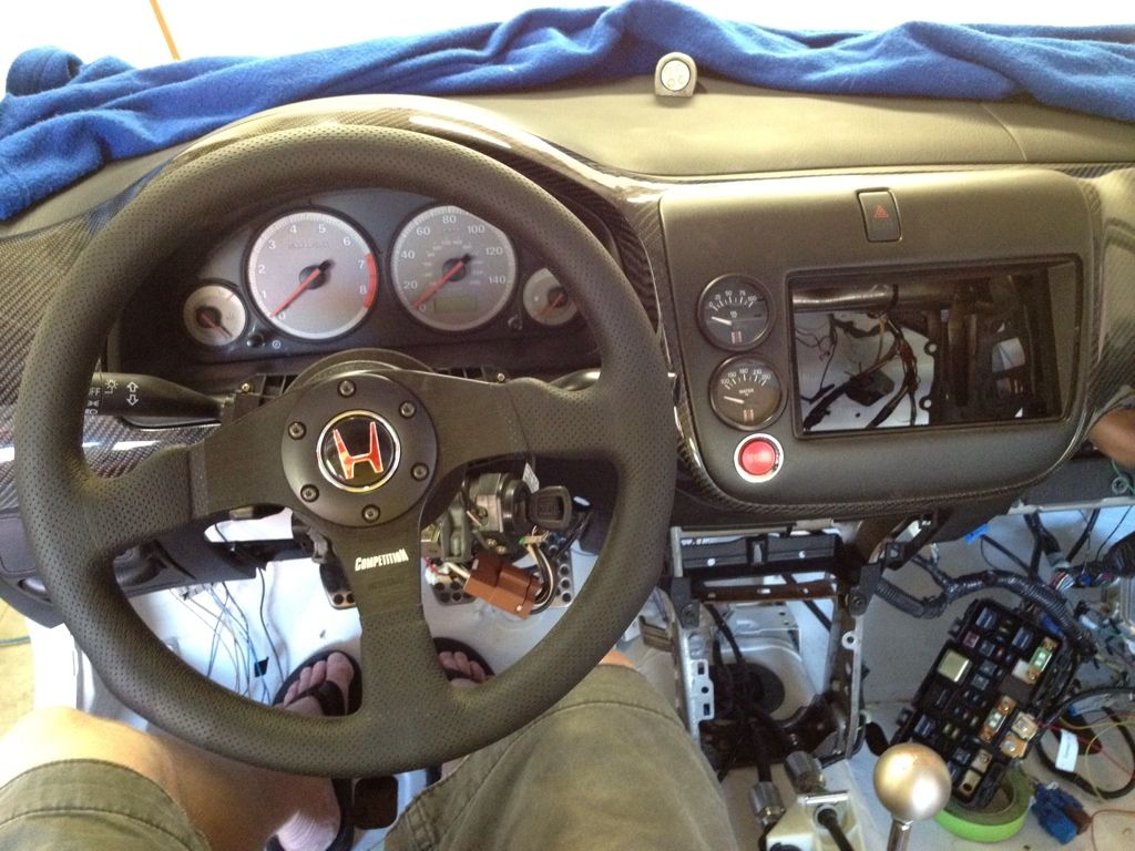

I have a DIY on k20 detailing how I shaved all the AC vents and climate controls and installed a S2000 push start and electric gauges.
Went from this:
To this:

Went from this:
To this:
