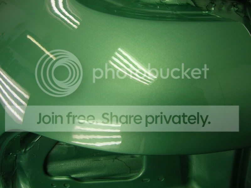

Don't know where you are getting it painted at but if they are a good shop, they should have a good painter. I usually just nib sand debris or a sag but I usually don't have enough orange peel that needs to be wetsanded.
Here is one of my latest jobs. Straight out the booth with only a wash, no buffing. It also depends on what materials they use, I use PPG and love the way it lays down, like a mirror

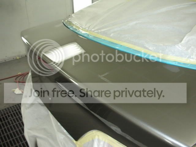

Peel battle!

Nice Looks like something I would do
you don't want none of this
