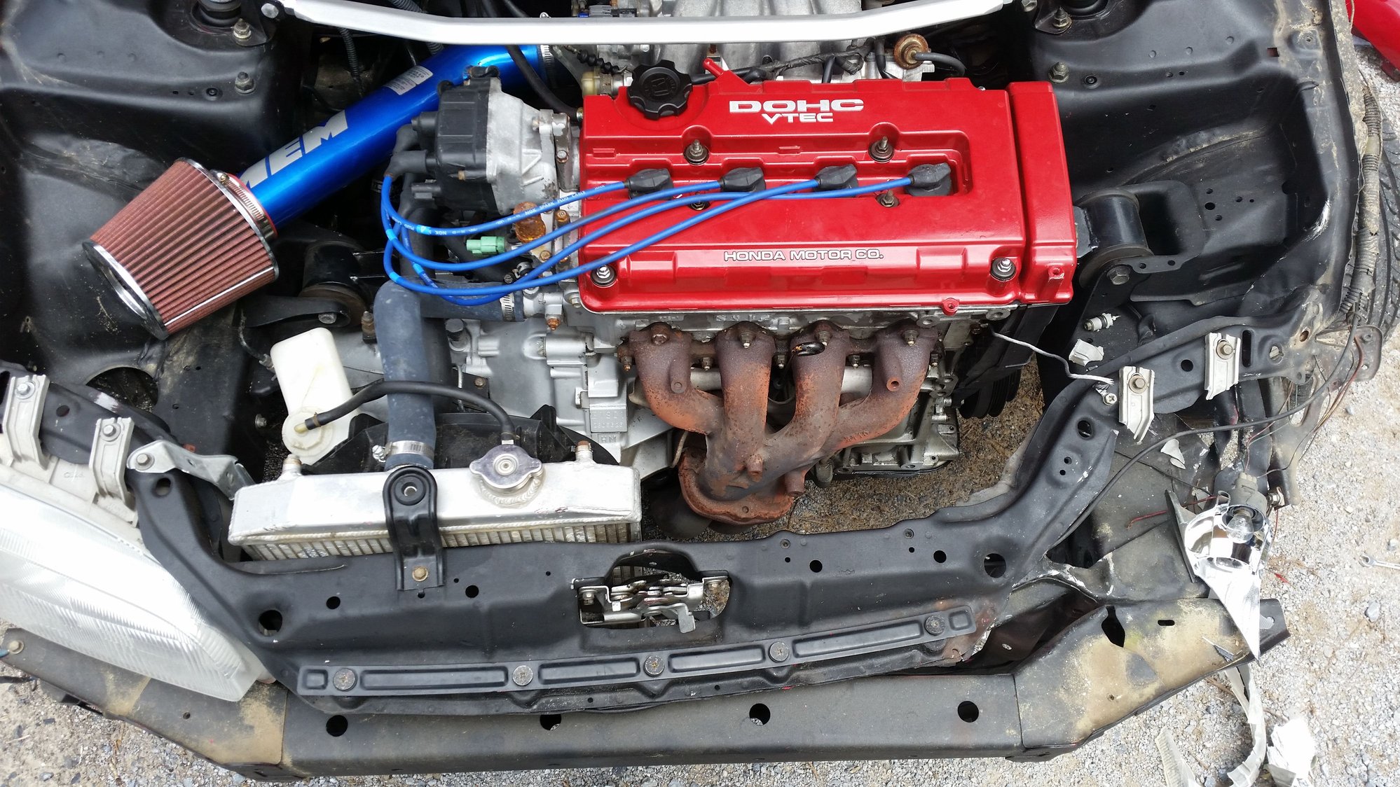

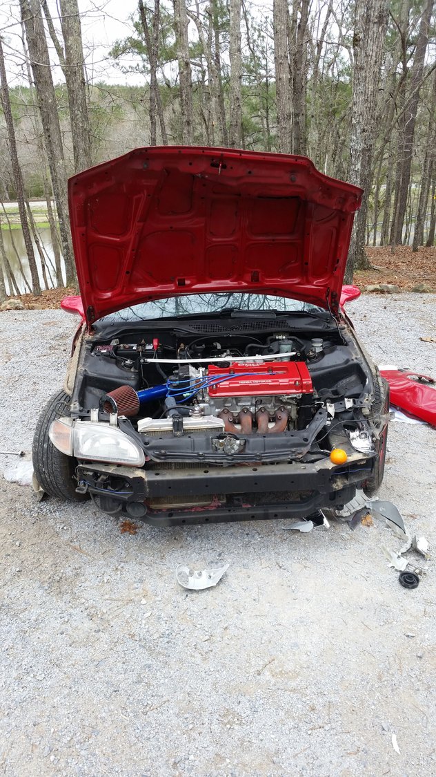

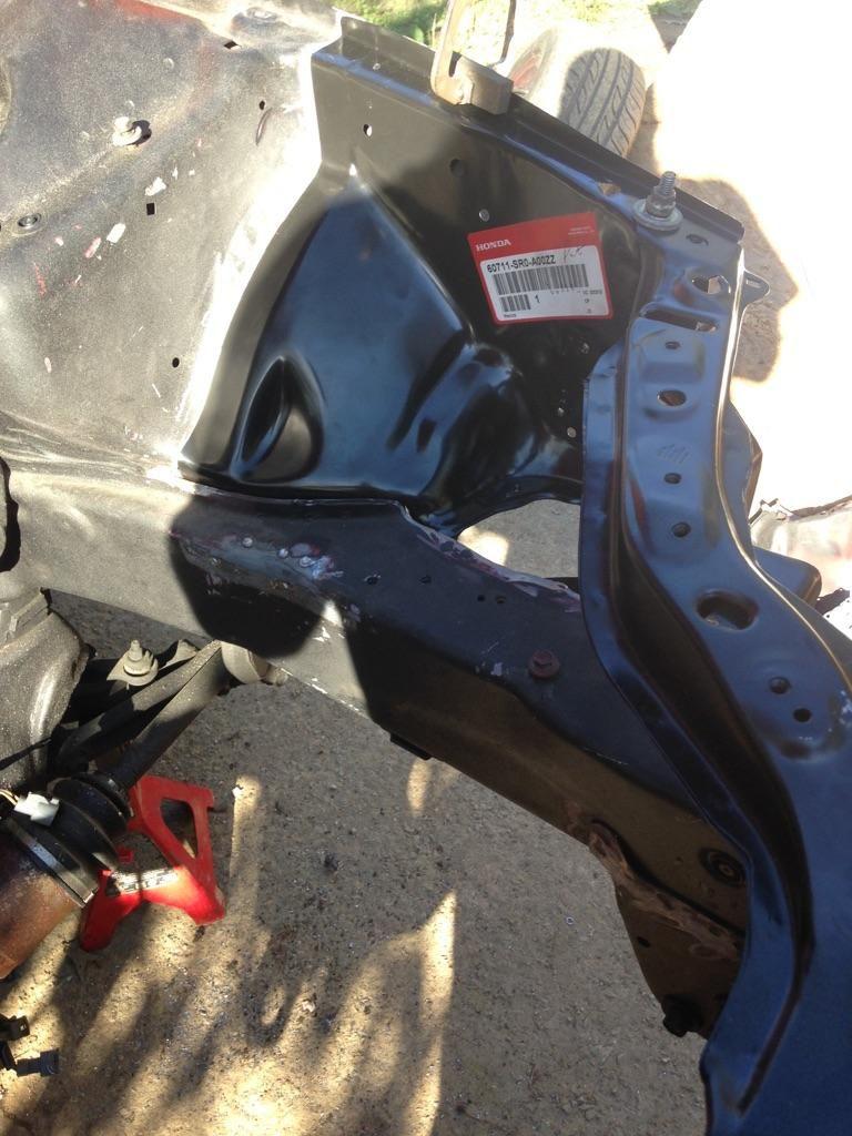

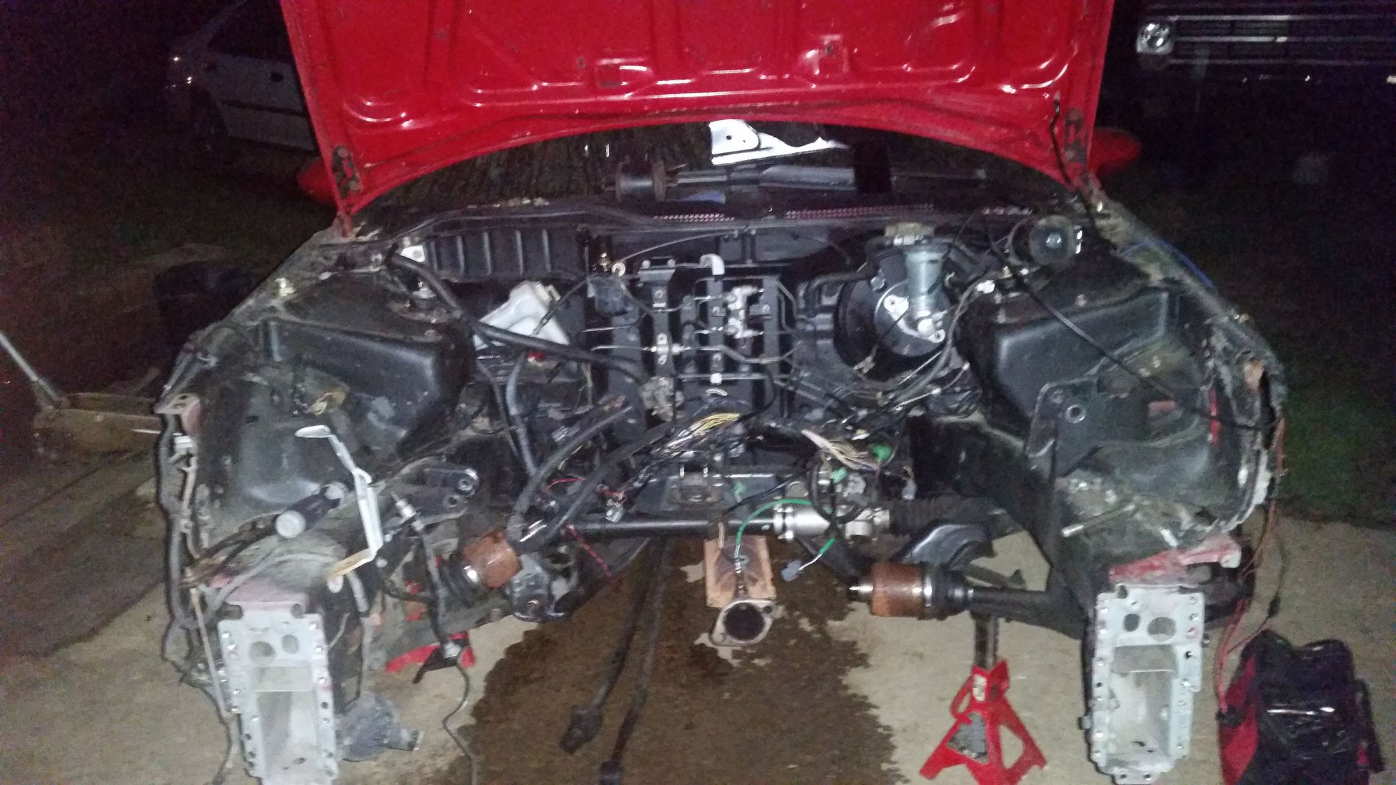

Hit a 60lb deer the other night 94 eg coupe

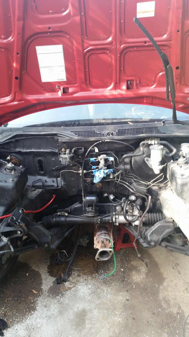

This is where we are as of right now, more to come soon!

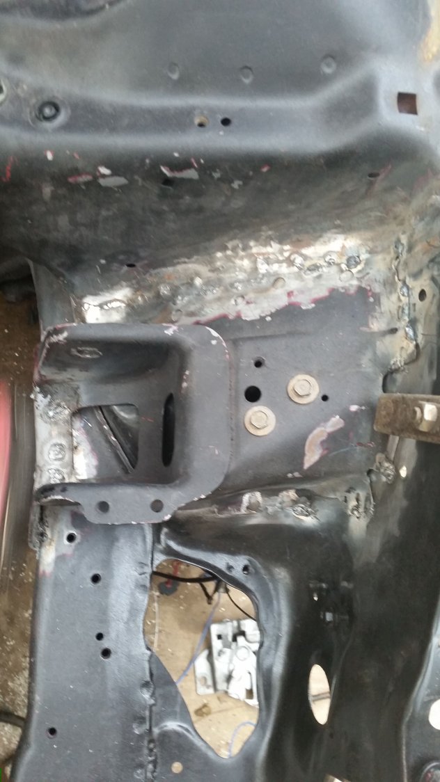

Great job. I have done this on the integra before. I had to make sure it was all lined up. When i removed the baffle I didn't remove the motor mount though. But looks great so far. Remember if the under parts don't line up, the exterior pieces and lines may look incorrect, like where the fendor meets the door and hood and bumper etc... I had to work with mine a little bit to make it look acceptable. Also with the sealant for the seems , take a brush to it for the oem look , kind of masks the repair work to those who don't know what to look for.

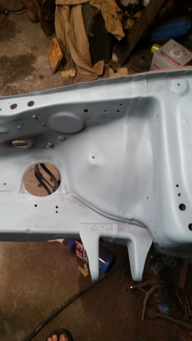

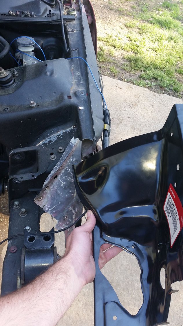

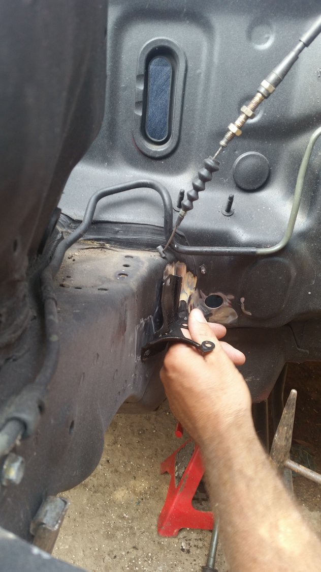

Here's some more progress
Wire tuck
Brake line tuck

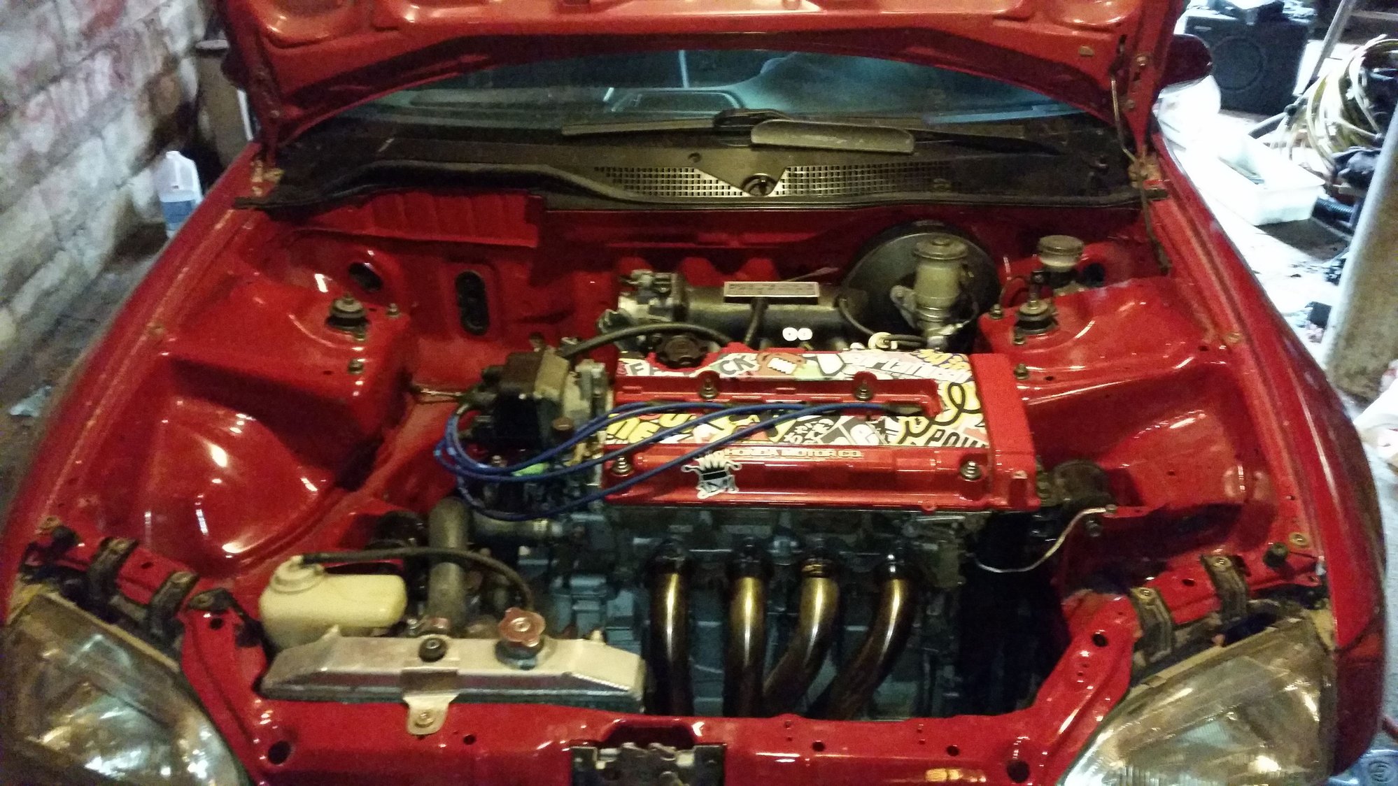

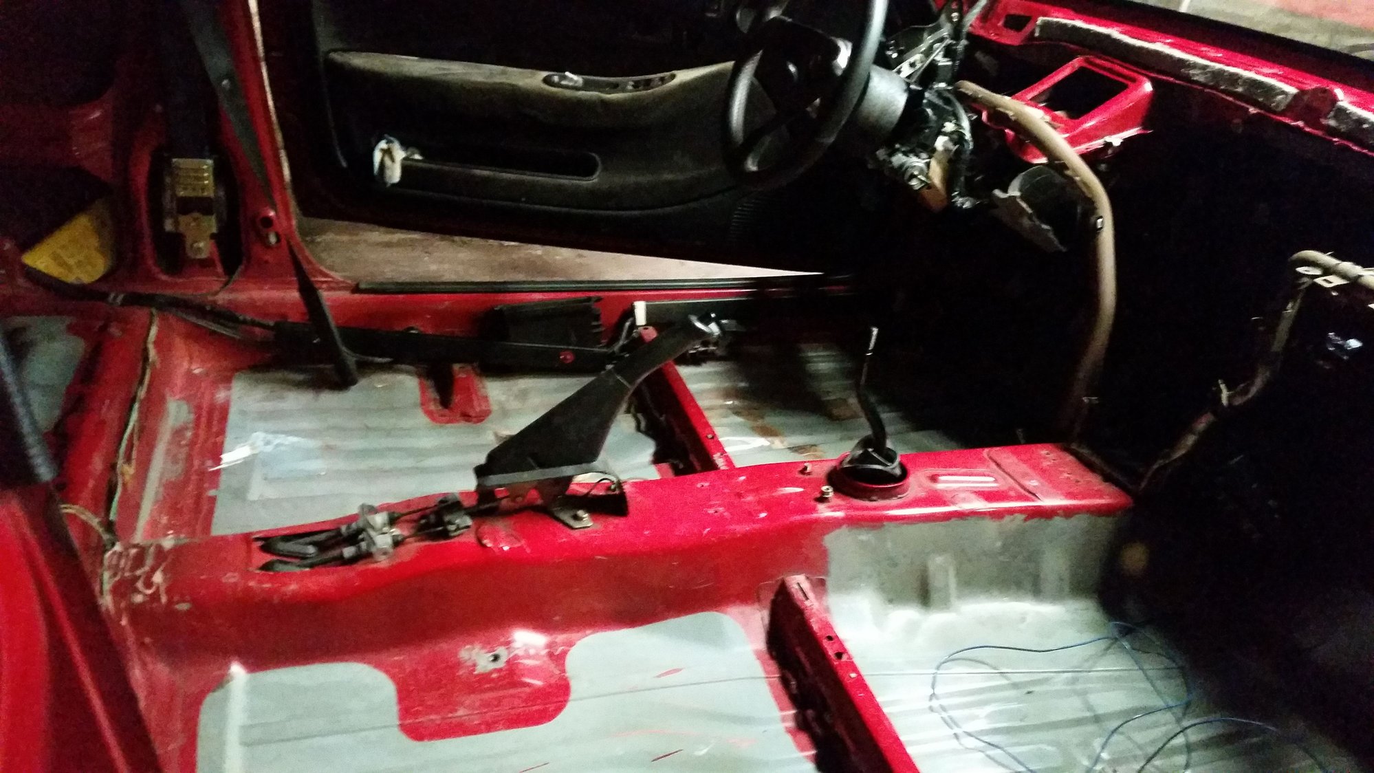

Finished pic I forgot to post
