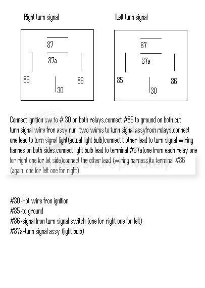

I Don't know if this would help whit this yellow lights but this is the way I'm running my turn signals as DRL as well as turn signals hope it helps.. the layout is for bosch relays with five terminals.

Default Re: rewiring high beam to a low beam switch ...help!! (FUSIBLE2DO)
mm thanks i was tryin to read it and figure it out but..didnt really understand it. i dont wanna change the left and right singal lights just wondering how to just have my high beam on only without turning the low beam. And like Duane_in_Japan said i have to cut the wires from the light bulb socket...ok ..... but do i do that for both lights left and right. still tryin to figure out the wiring set up. Ima draw it on paint and see if i can post it on so you can see what i mean.... thanks

Default Re: rewiring high beam to a low beam switch ...help!! (PurpleAccord88)
the wiring mentioned was so you can run your turn signals as DRL but still work as turn signals on top of that the turn signals get hyper mmmm about 120 p/m ... SUGGESTION ... run a relay with that switch so you take the load of the head lights from the switch...
