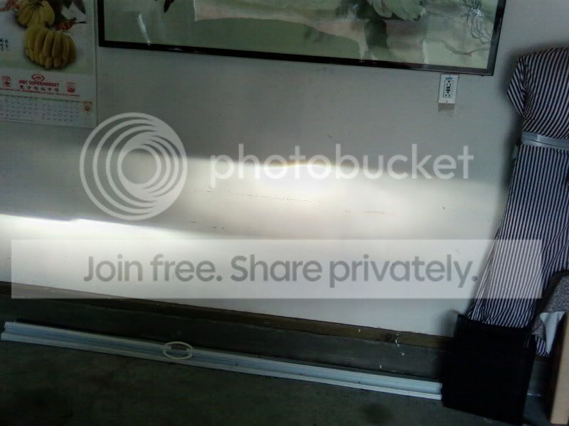

TSX is better than E46 when you're talking about output.. here..look at this to compare..
The left projector is the TSX projectors in the housing.. and The right is E46 outside of the housing.
The tsx is just more crisp and has a sharper cutoff. Keep in mind, that one the projector is in the housing, the lense flute the light output a bit, but the TSX still outperforms the E46. IMO, save your mula for the TSX. You might as well
