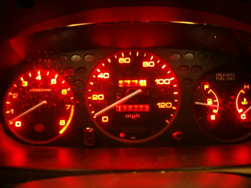

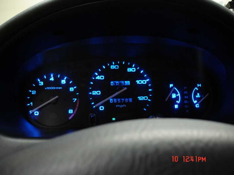

and i just want to make sure that i need 194 when changing the background light on the cluster to red on my 96 civic ex...thanks!!!
and also!! will blue look good? and does anyone have pics of doing this? thankss!!

Those led's are CRAZY DIMM, I've had several and I'd sooner run this style led's, their output will be brighter and fill the cluster better:
The main problem is the 96-00 ex cluster only uses <u>one</u> 194 bulb, the other four bulbs are #74 which most led replacement units are directional and only create a spot of lights over filling the cluster with light...

Those wide angle led units you listed are dimmer than standard 194 bulbs to the point of them not even being useable (least the ones I've gotten) for license plate lights...
I've not used this style #74 led but I think it'd be a good option if sticking to replacement bulbs:
LINK (just a bit down from the top)
I personally after doind the replacement led's, went the extreme and used led flex strips from Oznium, had to mod my cluster to make them fit but the output (after sanding the diffusing paint off the back of the gauge faces) is enough that when dimmed all the way down the lights are still extremely visable:

*pics from ozniums action page for the flex strips, I can tell you tho when fully dimmed they are only a bit dimmer than full bright with incandesent bubs... full bright is overwelmin (blue screw with your eyes at night BAD)...

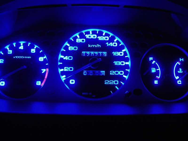

Yea I finished a full swap out using RGB ribbon strips, I mounted them along the edge of the hosuings firing inwards, this coupled with a custom rgb controller I'm able to get any color combo I want:
The red is what I'm running currently, since when at night it's the best for not messing with your eyes. The blue with this set up is bright but the green takes the cake... The controller also lets me do crazy things like fade and strobe the leds:
