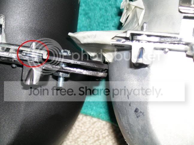

<TABLE WIDTH="90%" CELLSPACING=0 CELLPADDING=0 ALIGN=CENTER><TR><TD>Quote, originally posted by HIDPlanet/haknslash &raquo;</TD></TR><TR><TD CLASS="quote">This is how you get nice sharp blue, purple, red. The colorband will also stretch throughout most of the cut-off when you back up past 25 ft or so doing this color mod.
Place (4) #8 washers on the 2 bottom nipple posts (2 washers per each nipple). The washers go in between the front and rear halves of the TSX projector.
Location of one of the nipple posts. The other is right next to it (not visible in this angle).....

but wouldnt only putting washers between the case on the lower half of the projector make is seal crooked. The top half will be sealed tight while the bottom half with the washers will have some kind of gap...?

the housing doesn't fully seal in either set up (i've got a set of TSX's)... But the projector should be housed inside of a headlight and at most only the rear exposed which is as far as sealing problems should be concerned..

can usually seal it up with some aluminum tape. so no light leaks out.
