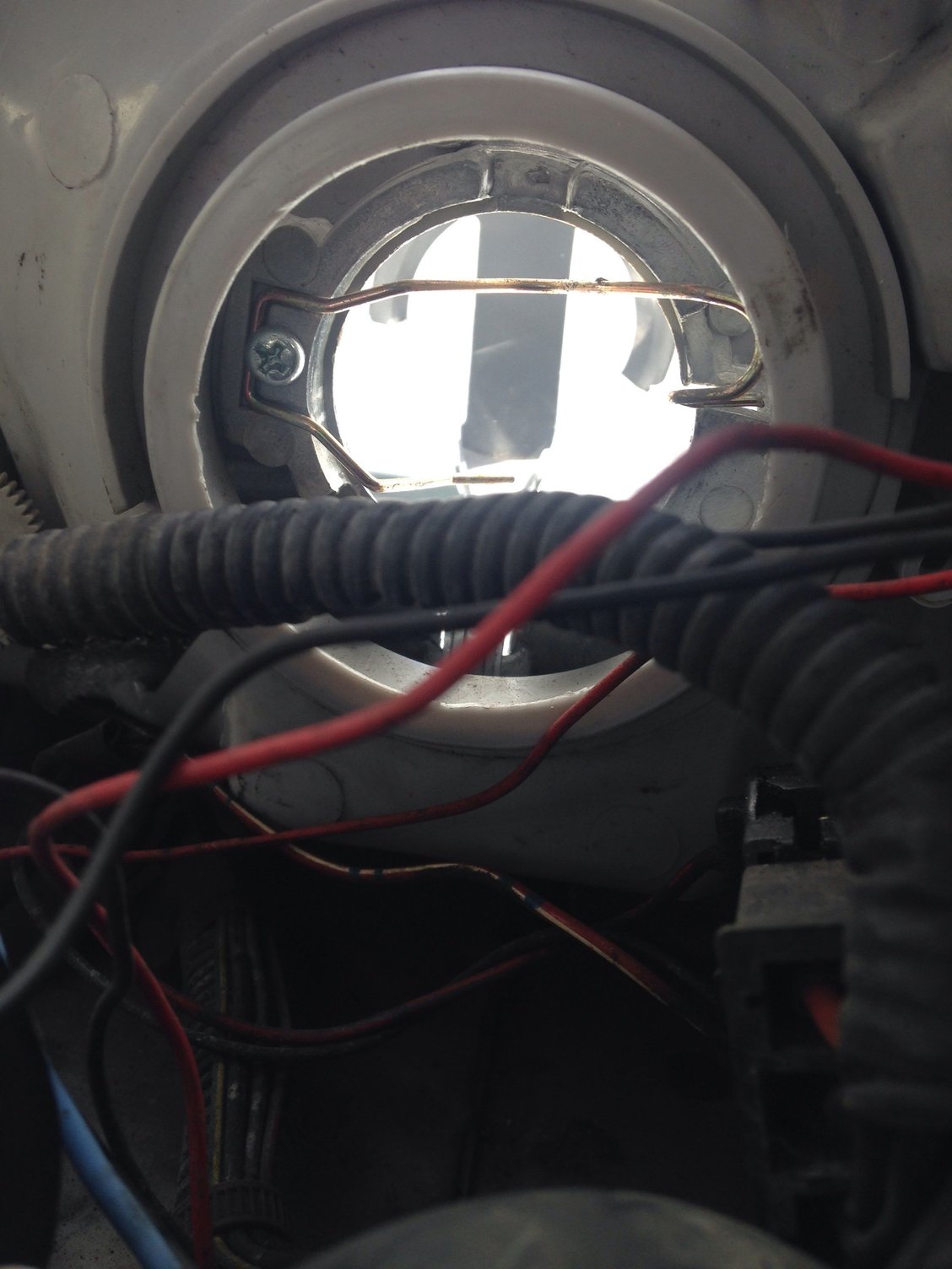

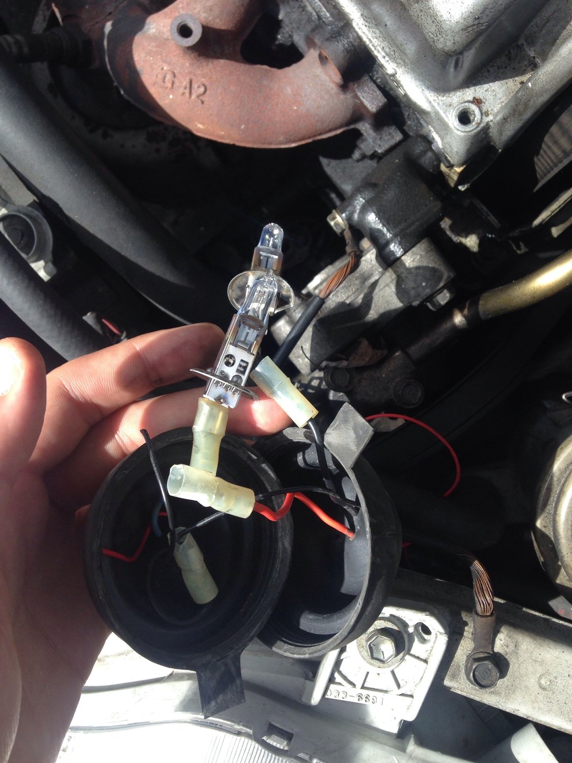

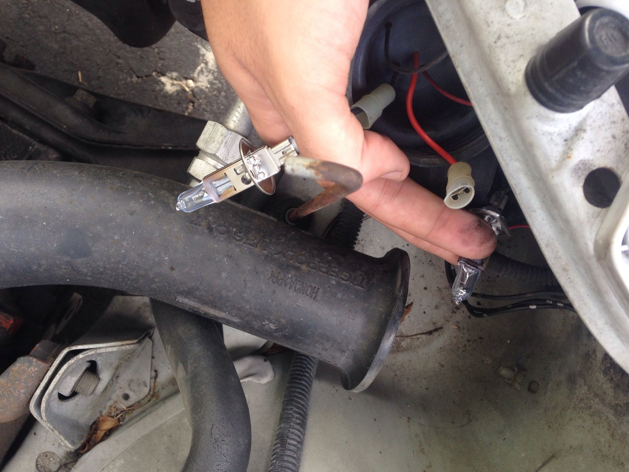

I had some crazy ricer headlights that i removed and replaced with oem. Now heres my problem the light bulbs dont fit. Obviously they arent the correct ones. I dont want to mess this up because i cant stand wiring issues so can someone tell me exactly what i have to do? Thanks

For a 97 EK the OEM bulb size is H4 . The bulb you have in your hand is an H1 . So get H4 bulbs and you should be good to go . Is the wiring on the car untouched or is it cut and spliced ?

Im not entirely sure, if im not mistaken i think it might be cut an spliced or these bulbs have some sort of harness that comes with. I will double check later on and let you know thanks alot
