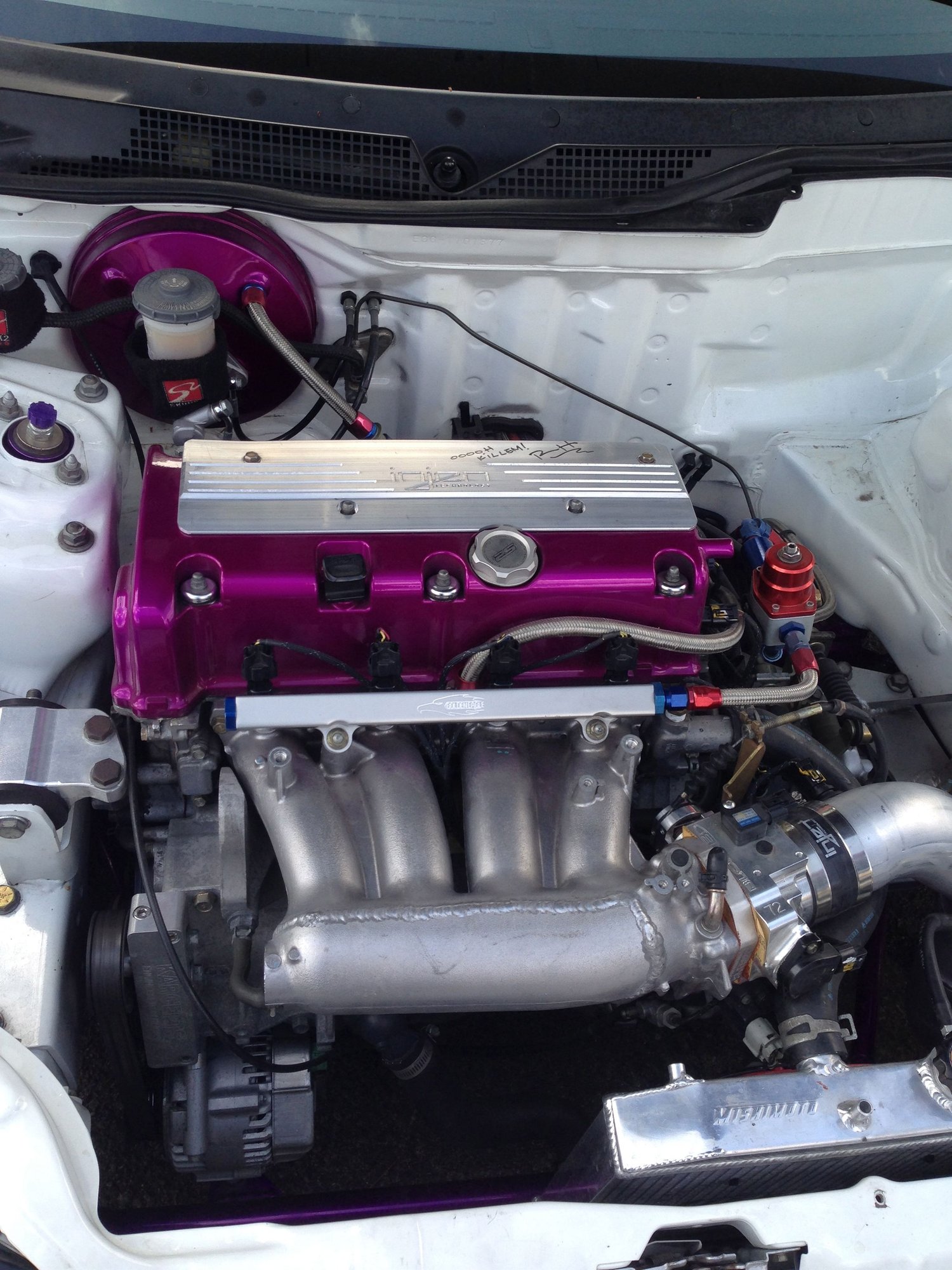

I have a K20A in my 93 Honda and it has power Steering but no ac
I got is like that So i don't know all the Details but i believe you use an AC Delete pulley
Old Jan 12, 2015 | 06:36 PM
Michaelw89's Avatar
Joined: Jan 2015
Posts: 7
Default Re: Power steering without AC???
oh **** my bad that pic is before i added power steering but i did have to make change the ac delete bracket to make it work ill take a picture when i get to my shop tomorrow so you can see

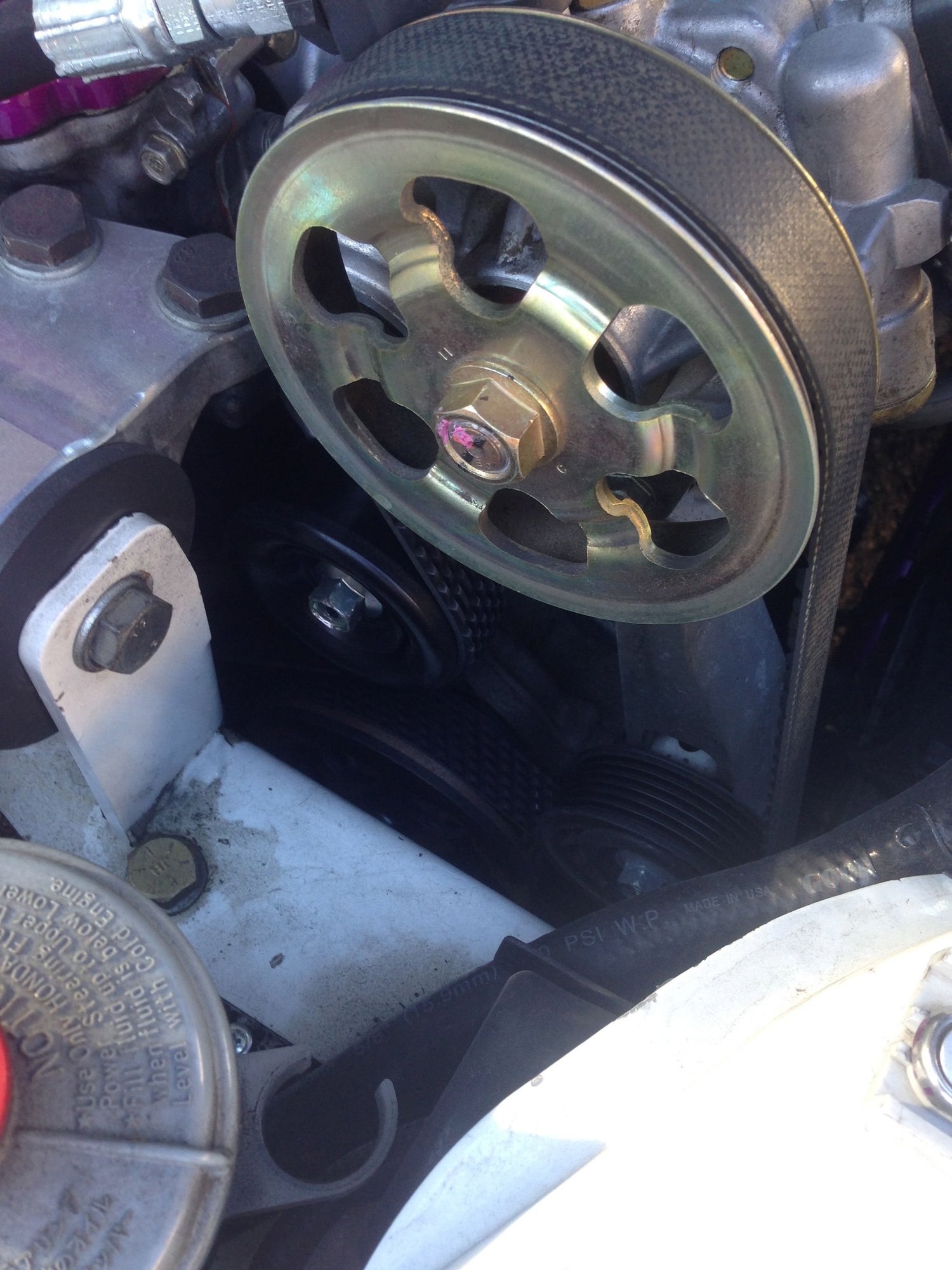

bottom right is karcepts ac delete pulley
