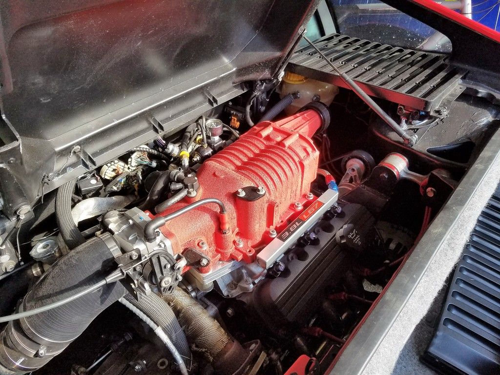

Not sure if this is the right place to post this. I am in the process of swapping in a K20A2 into my 1988 Fiero GT. The car has 15k miles on it from new. Its been a test bed for many parts I have developed over the years. I have partnered up with Euro Pacific Auto Tech here in Panama City, Fl. I don't know anything about Honda's. My buddy Antonio talked me into this after watching vids of the K swapped MR2 on YouTube.
Have a look at my build series I will be posting on YouTube. Be gentle, its my first time!
Current engine is a 2007 Pontiac Grand Prix L32 3800sc mated to a F23 5 speed from a cobalt. Good for approximately 300whp
