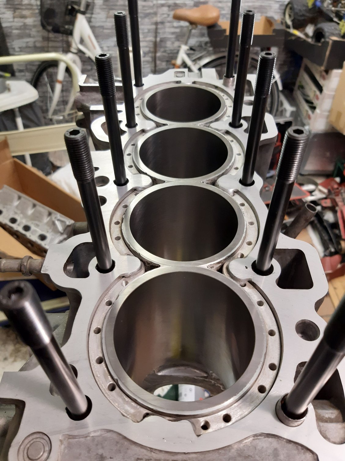

Hello i,m stephan and i have a crx vtec ee8 for 12 jears now with a turbo on a stock block on 6 psi +_ 225 hp,but it was time for a upgrade so
i recently build an other b16a1 .speclist,:
J.E forged asymetric pistons 81.5mm
Supertech blok guard
K1 forged rods
Darton sleeves
Block just came back from the machine shop
Stock polished cranck
Sk2 stainless valves+
Titanium retainers
Ferro bronz valve guides
Sk2 dubb.springs
Bc stage2 turbo cams
Acl bearings race series
Precision pt5558 turbo
Bloks adjusteble camgears
Lsd
Insane driveshafts 500hp
Hasport motormounts
Obd1 hondata s300 v3 p28 ecu
Msd al6 ignition
Competition clutch stage5
act
Arp mainbearing studs
Arp headstuds
Blockgirdle
Ported stock oilpump
Extra oilcooler
Aluminum 60 mm 4 row radiator
60×30 3" intercooler
3"rvs piping
hks blowoff
Stock intake
3 bar mapsensor
1000cc injectors
Adjusteble fuelregulator
Wallbro 450lph fuelpump
high flow fuelrail
Ramhorn manifold
3"exaust pipe tot achter
tial 38mm wastegate

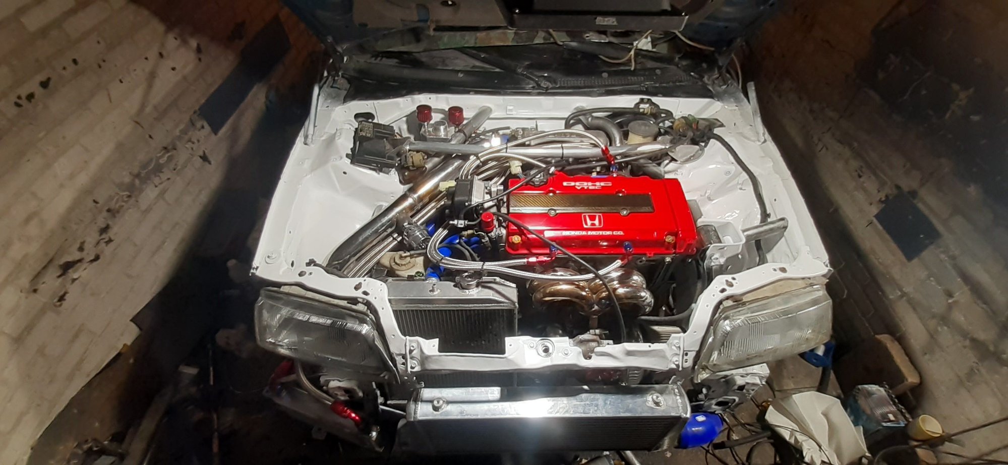

The new build b16a1 is already in the car and working on the conversion harnass and p28 ecu with the hondata.
The new build b16a1 in the livingroom
Almost finished
