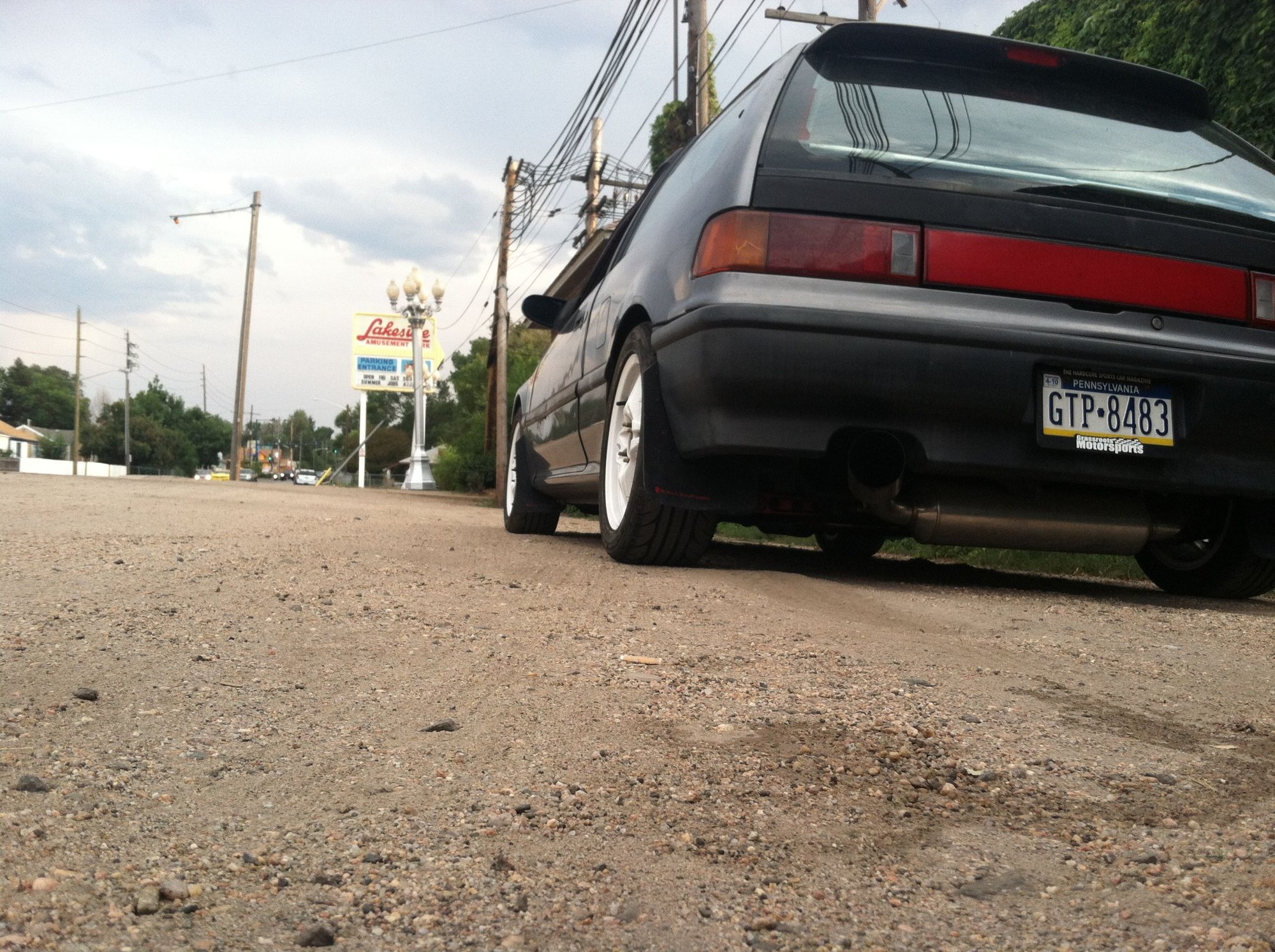

So this is my second time joining up, Only about 10 years later! I Have a 1990 Honda civic Si hatchback, full swap! For all my D series guys!!!! My newest of my collection. She was left for years and rotted out, blowing the head gasket and seals everywhere. I am in the works of doing a full rebuild plus a few extra mods and touch's.

D15b vtec with Si transmission running 4 pounds of boost on a td04L with 450 cc injectors running on a p28 computer with a base map off a d16y7. She isn't much but she's making way. Head gasket replaced and valve gasket, still a little oil leak from the oil pan gasket, Running way better, No air or rust in the engine anymore, Still has a bit of a idle problem when warmed up, My guess is a major boost leak somewhere in the fmic piping. So Im currently searching for that!
