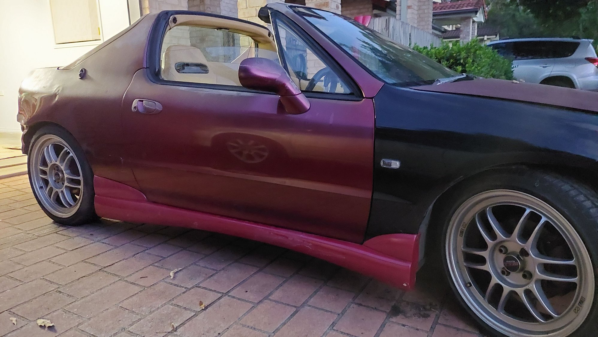

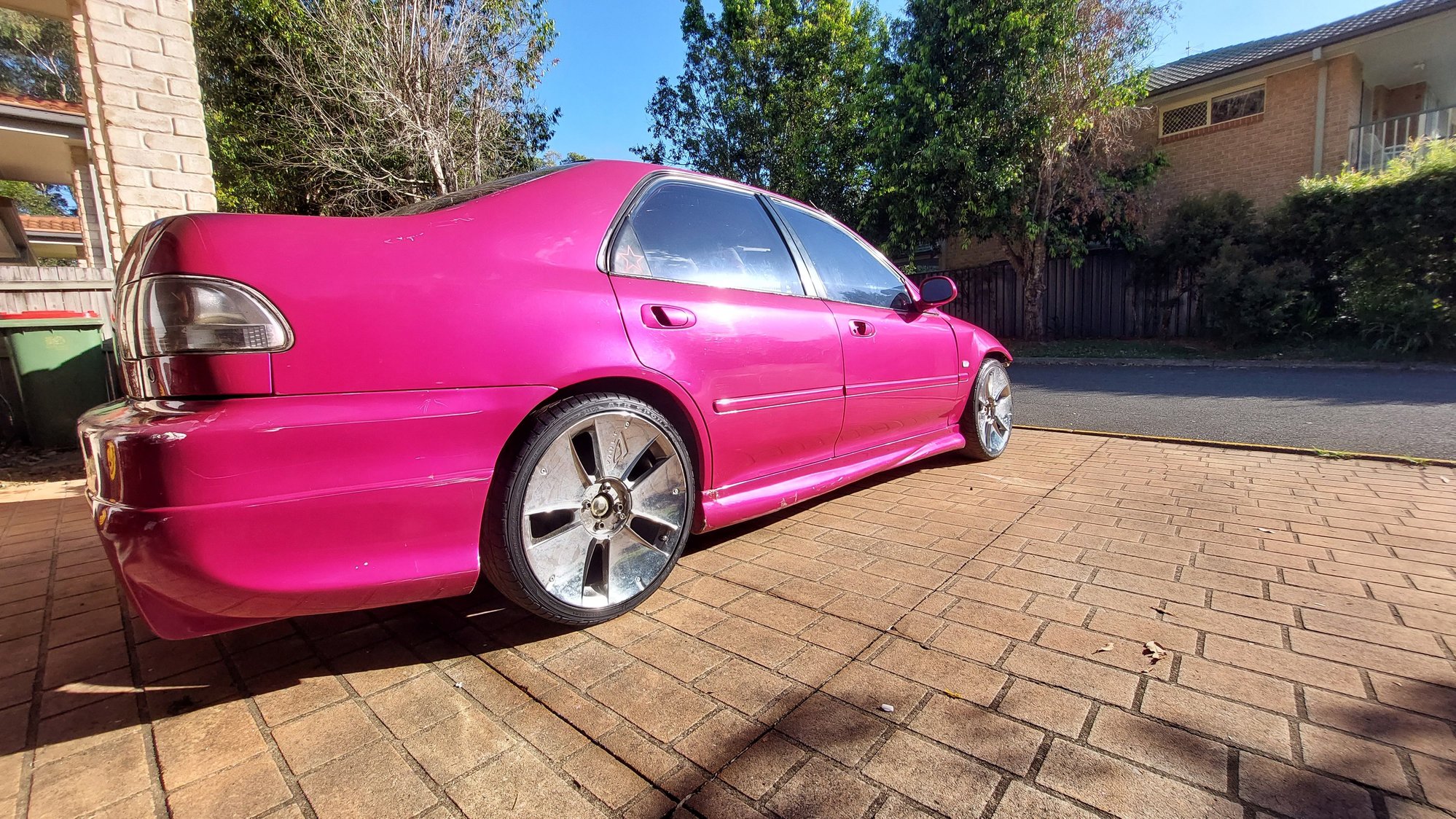

OK I've just purchased two little projects. One is a EG civic sedan with a B16a manual transplant and a 93 Del Sol b16a. Both cars have been sitting for a number of years.

Previously a show car that had candy paint 20 years ago.
This hot pink mess is literally that, a mess haha
