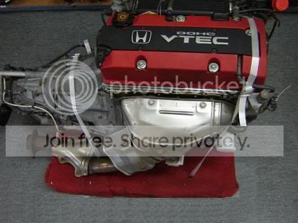

Short story: After owning and building my fair share of Hunduhs(sp)
the last 6 years, i thought it was about time to get outta the vtaks game...
my last honda was a k20a powered Ek hatch... before that was an h2b powerd Integra, and before that was an h22a turbo civic coupe...
and by now i was getting a tad bored of fwd... so i swapped my EK for this ae85 levin... and a 98spec ITR...
and it came with one of these donks in it... what looks to be a 1600 twin cam thing... meh who cares what it is... its says toyota and it makes the wheels turn!!
quads and all!
came with a full 6point MANZ cage, along with log book... hoorah!
supra gearbox and hilux diff and coilover suspension up front and TRD springs in the rear..
a set of oldschool volk reverse mesh wrapped in dz101s up front and Trampio's! on the rear hold this beast to the ground!
after driving this thing for a month, all i can say is.. its an animal!
the tacho dusnt work, the brakes dont work but who cares its a great barrel of fun!! the lil 1600 4age pulls quite well and a kick of the clutch sends the whole thing in an opposite direction! i think its called drifting/spinning out but who knows im still learning the rwd lingo
ANYWAYS, to turn a long story short... I ended up selling my 98spec ITR to some theiving asian bastard (friend of mine) for the sum of 10,000 and being my 22nd birthday decided id go shopping for my self......
since the ae85 only had one seat no heater and no stereo and i just sold my ITR beator... i had to pick up a new run about
phooooar ! another corolla! i realy have turned to the darkside now!
Next on my shopping list was a trip to the liqour store
sorted!
after that i ended up going to sleep ( most likely from driving the new beater..) or from watching the rugby(worldcup).. take your pick
saturday rolled around
and 3rd on my shopping list took me to auckland...
after getting lost for a good half an hour EVEN with a map..
I finaly got my hands on some new shoes for the AE
sport maxx 15x8 with zero offset.... and ruffly 3.5" of dish.... quote borat here ________ yum yum
now seeing as it was my 22nd and all, and my 21st was **** poor i had to redeem myself for this year.... I took my big wod of 10k cash; less for the wheels and headed on over to strong for honda... auto dismantlers
after a quick **** in the showroom looking at this
I pulled up my pants and handed over some more moola....
.....2 hours pass..... and a carefull drive back to hamilton and
this now resides in my garage
plans are to also panel and paint the car!! i sorted out a deal with one of my good friends who has done a bit of both... and i sold him my toyota drivetrain to pay for it all
