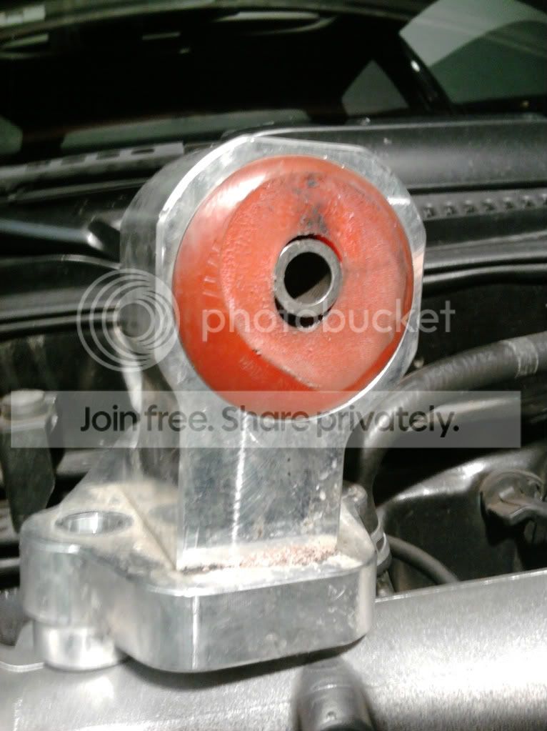

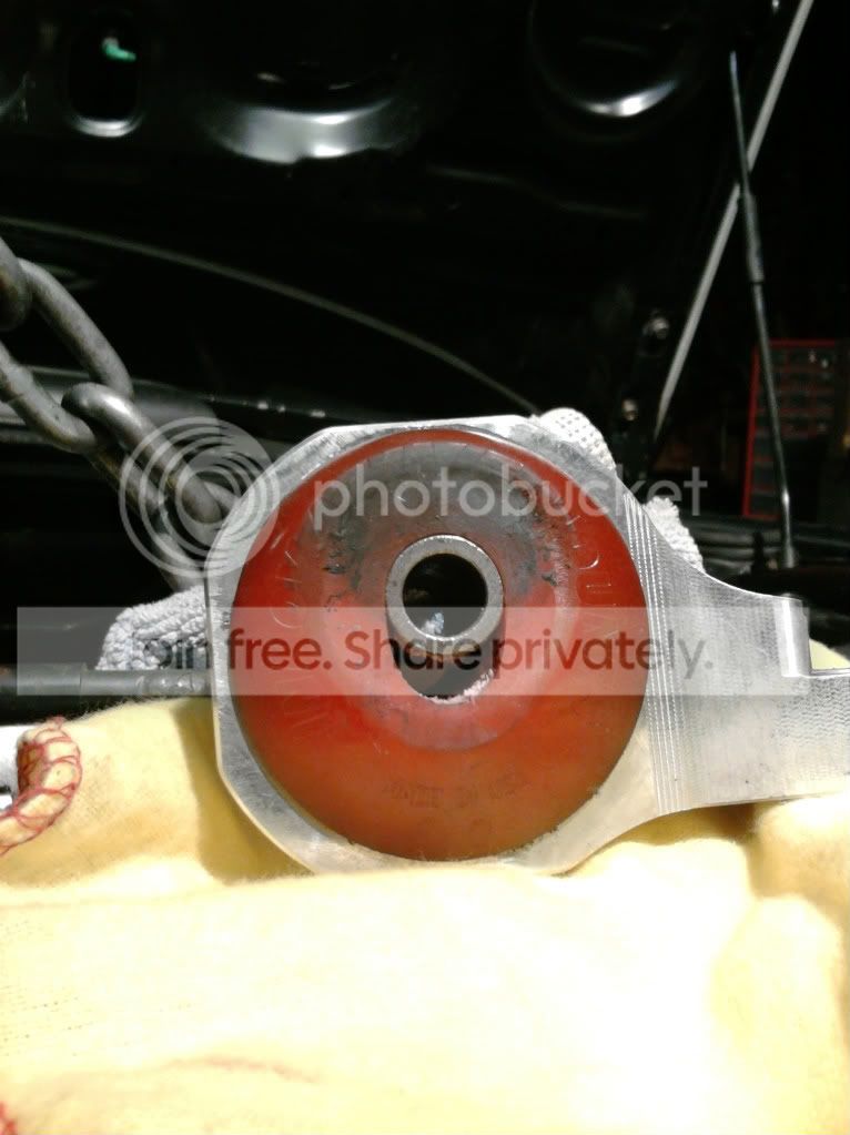

Man am I upset with my Innovative Mounts (billet 60a).
I've been chasing what I thought was a suspension issue, turns out the soft polyurethane has failed. The center collars in each of the mounts has way ovaled out the poly and actually lowered the engine by an inch.
These mounts are about 2.5 yrs old and have only seen daily street abuse.
Has anyone experianced this failure on any other mounts?

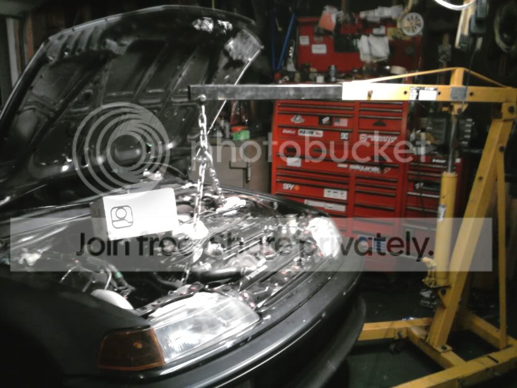

Some of the carnage...
Trans mount
Driver mount
Driver mount
How she sits now...
Still gotta pull the rear mount. :?
