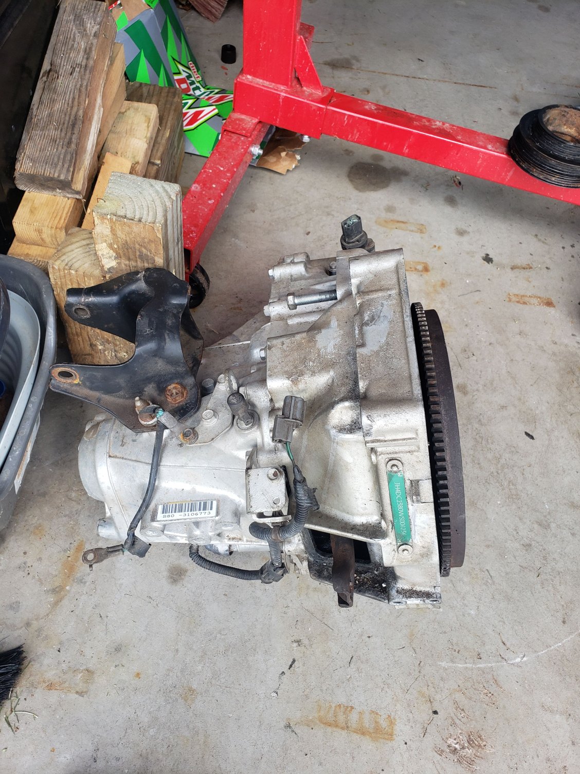

Motor is a B18C1, Trans is a S80

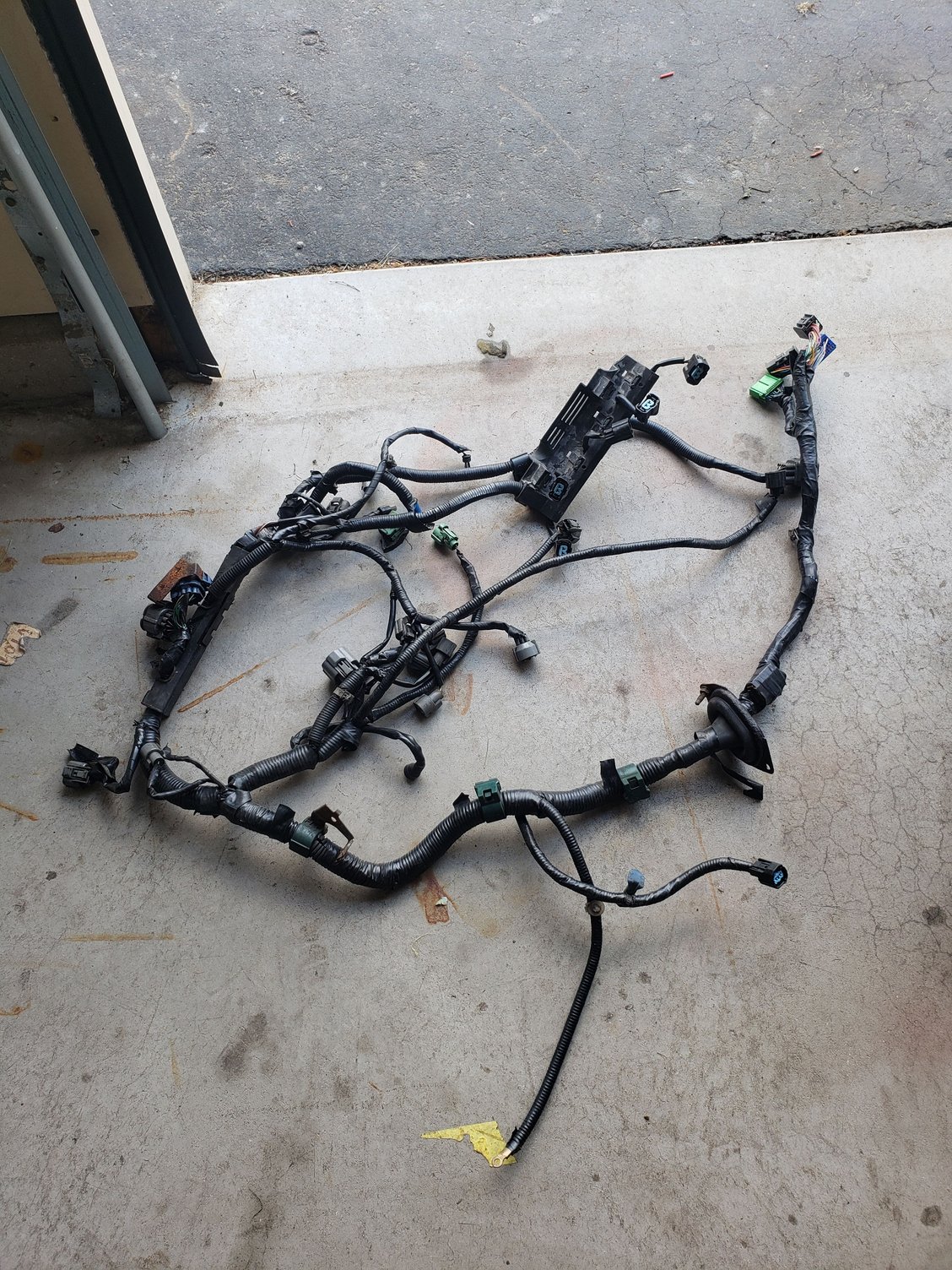

I have a wiring harness from the donor car

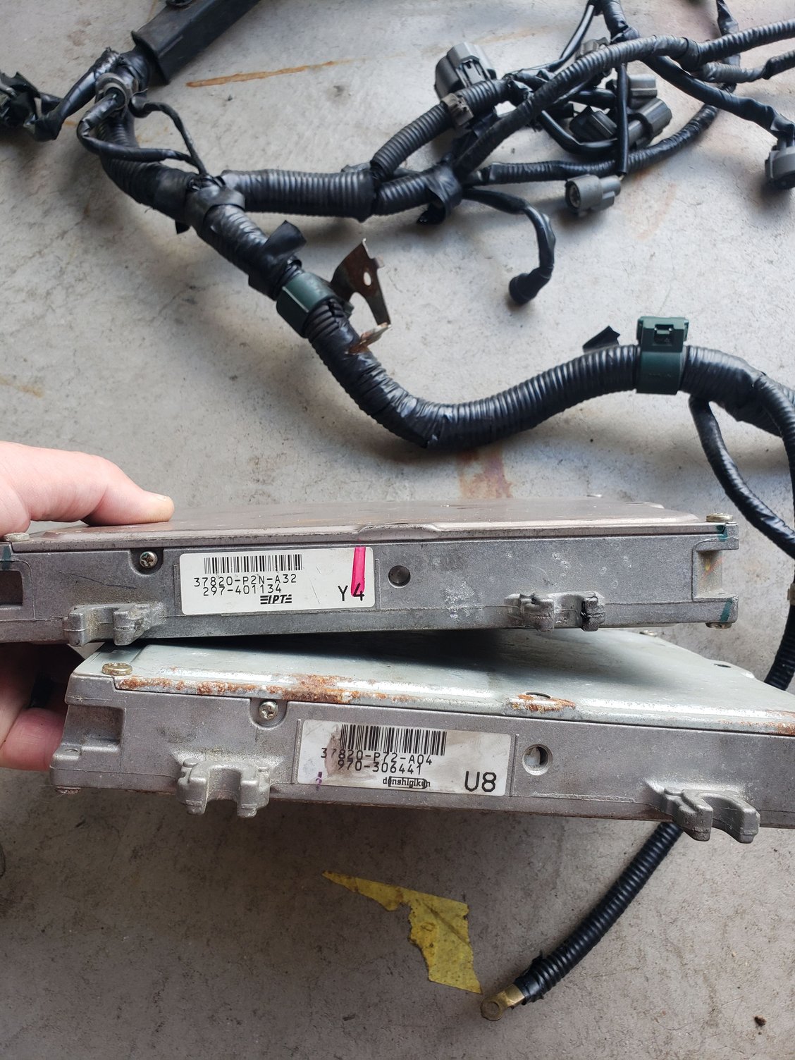

I have a P72 obd 2 ECU

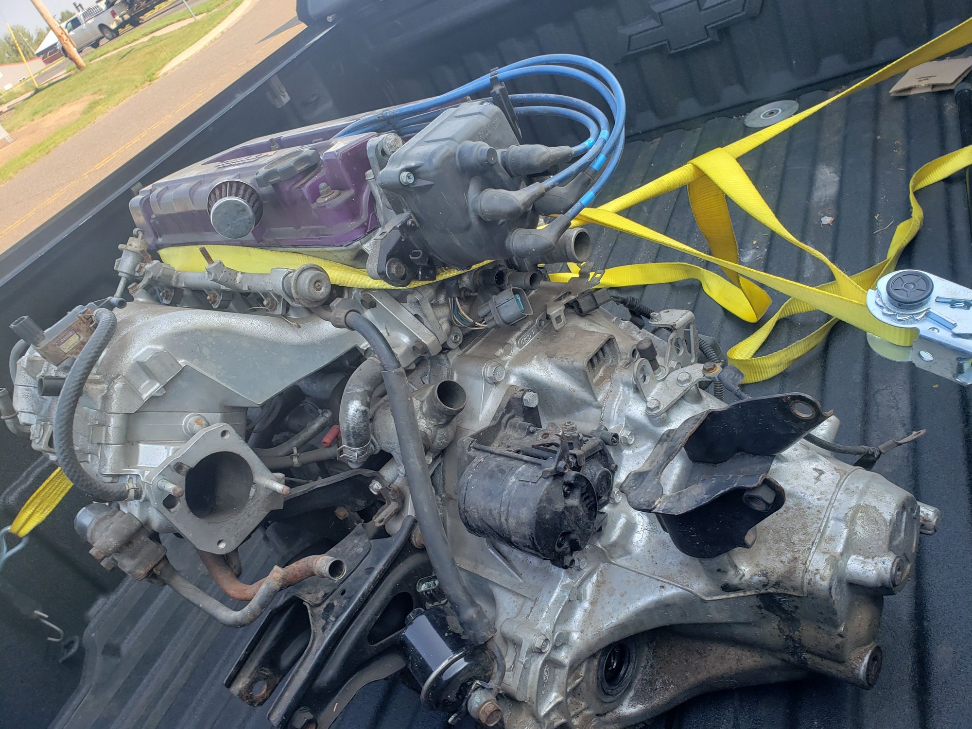

I have all the mounts that came on the engine/trans which should bolt into my chassis?

You will need the rear t bracket which only comes from a 99-00 civic si.
You may need the drivers engine bracket from a 97-01 crv, depends on your current mount.
Throw away the vtec controller. Hopefully you have an obd2a p72.

I do have a P72 ECU
Came with a second one as well not sure what for? Maybe the guys other civic that was crashed.

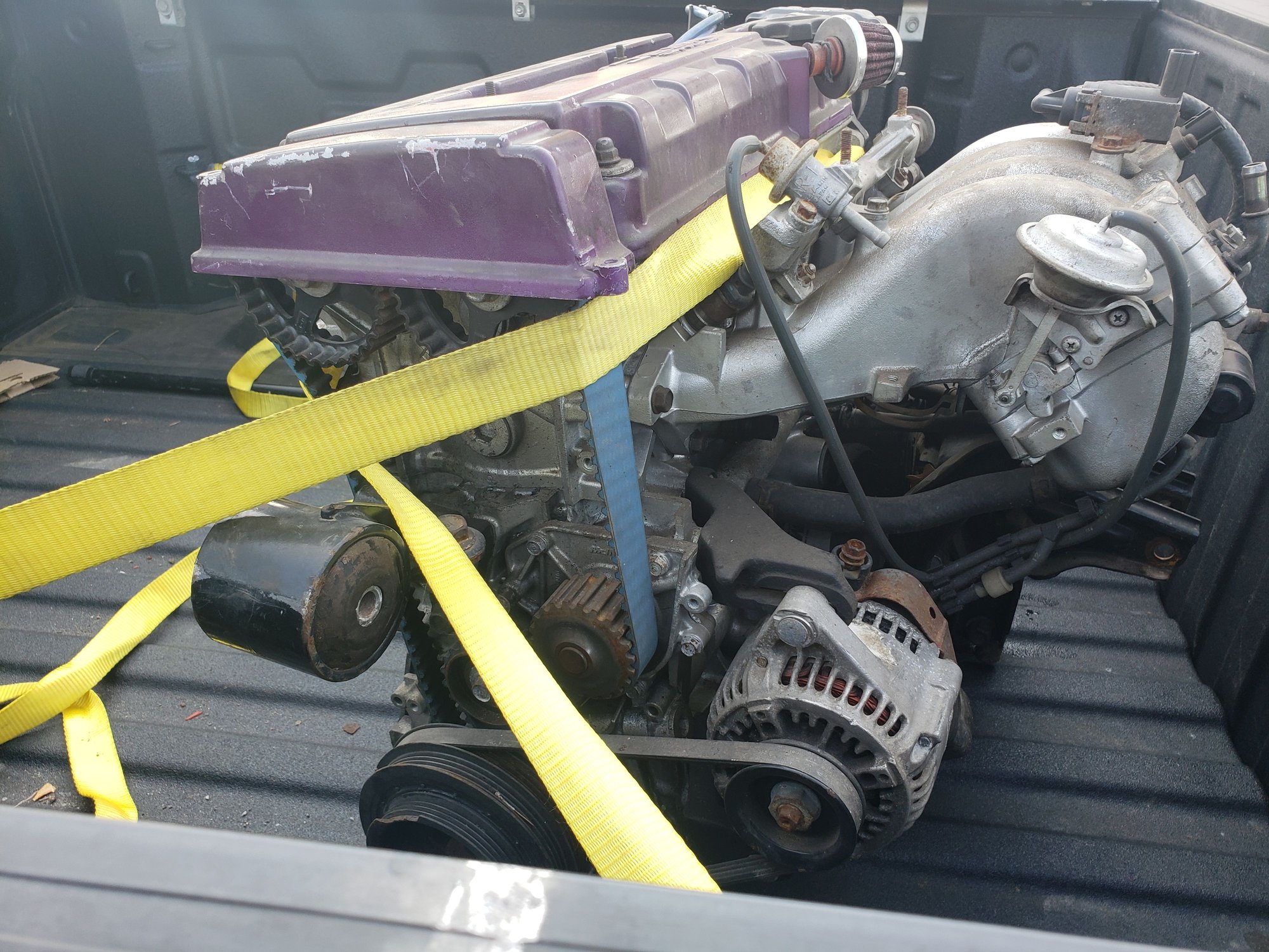

Also, In the one photo you can see they had the Intake advanced 1 tooth.
Was this done to bump the compression? I believe I read that is why this is done sometimes.
We do plan to boost it so should I put the timing back?

The p72 you have is likely obd2b which has an immobilizer. Unless you have the key and sensor ring that matches the ecu you will not be able to use it. The other ecu is useless as well. You need a 96-98 p72.
The mechanical timing is just wrong and hopefully there is no damage to the engine if it was run that way.
Old Jul 22, 2022 | 11:18 AM
10sectyphoon's Avatar
Joined: Jul 2022
Posts: 13
Default Re: Feedback on B18C1 swap.
Per the Hondata website its an OBD2A as the far left plug is used as well as the 2 far right plugs. So good news there I guess.
Timing wise, I should just pop the head off and have it checked for bent valves and then start over new?

Good news for the ecu. You could probably get away with setting the mechanical timing correctly and from there rotate the engine by hand. If it rotates smoothly for at least 2 crank revolutions you could install the trans and starter and compression test it.

All set on the timing now. I used a bore scope and the pistons due have some carbon on them but I didn't see any contact points.
I also turned the lights off in the garage to see if the light from the bore scope was making it into any closed intake or exhaust valves
I know its not exact but an extra step.
