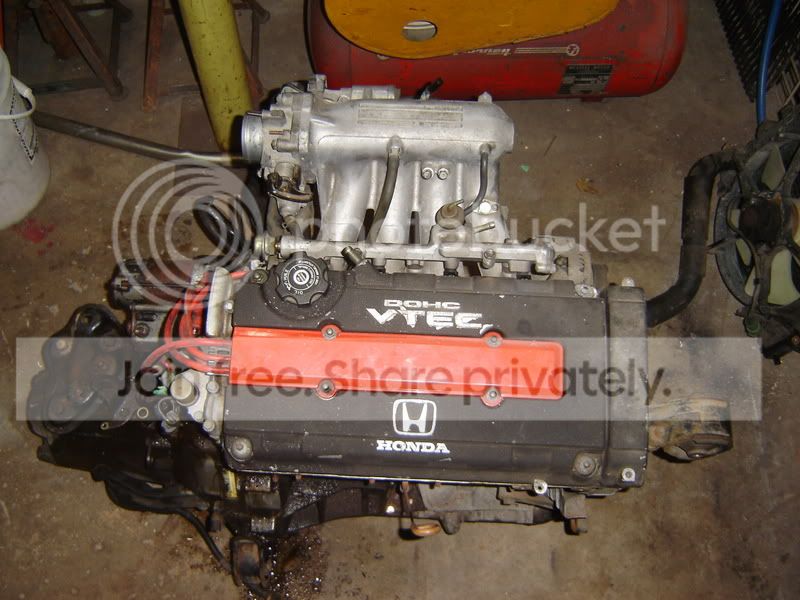

looks like an OBD1 to me. I remember reading that the size of the font on the "DOHC" and "VTEC" parts can indicate OBD0/1 (as long as the valve cover wasn't changed), also I believe the OBD0 B16a's had the "PGM-FI" stamp on the plenum.
In any case it doesn't really matter; the OBD1 engines have slightly more aggressive cams so they make supposedly like 10 extra horsepower. The only differences on the engine are the distributor, fuel injectors, and exhaust manifold (OBD0 had 2 O2 sensors most of the time). But obviously all of those things can be swapped.

Some, OBD1 B16As, maybe all have a firewall map sensor. A friend of mine has a '92 RHD JDM SiR EG6, stock B16A firewall mounted map sensor. Theres a few other things that make me think its OBD1 as well, vtec solenoid plug is grey, OBD0 versions are a milky clear color, intake manifold doesn't have PGM-FI like most honda OBD0 engines. Easiest way to check though would be to simply check the date stamp on the head, its next to one of the exhaust ports.

I'm not too sure about which stamp you're talking about but here goes nothing.

Can anyone decipher these stamps/castings?
EDIT: If it is in fact OBD1, does that narrow down which type of B16A it is? I've been told that block stampings without any number suffix after B16A- means that the motor is JDM. Now, does the fact that it might be/is OBD1 mean it's from a particular car?

the 9/2 stamp indicates that the engine was manufactured in '92 thereby making it OBD1, its most likely from JDM Civic SiR or JDM integra. The block stamp should read B16A if its JDM or have a number after the A if its from another country.

The vtec solenoid has a obd-1 plug on it. It's hard to tell because both obd-0/1 are so idenical visually. Intake manifold is deffinatly obd-1, throttle body obd-0.
Pull a spark plug and see what the piston says. p30 means obd-1, pr3 means obd-0.
I believe they changed somthing internally because obd-0 b16's are 160hp, and obd-1 are 170.
