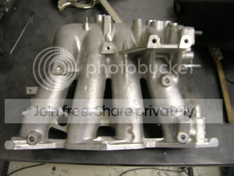

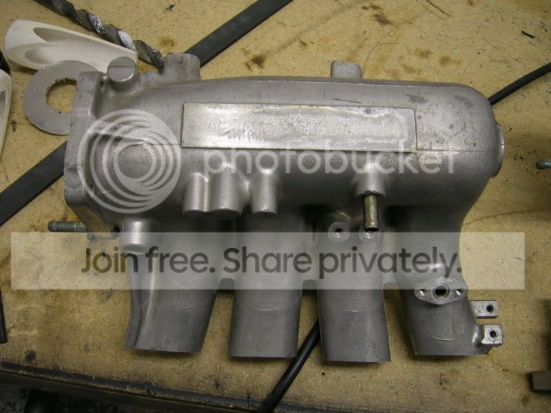

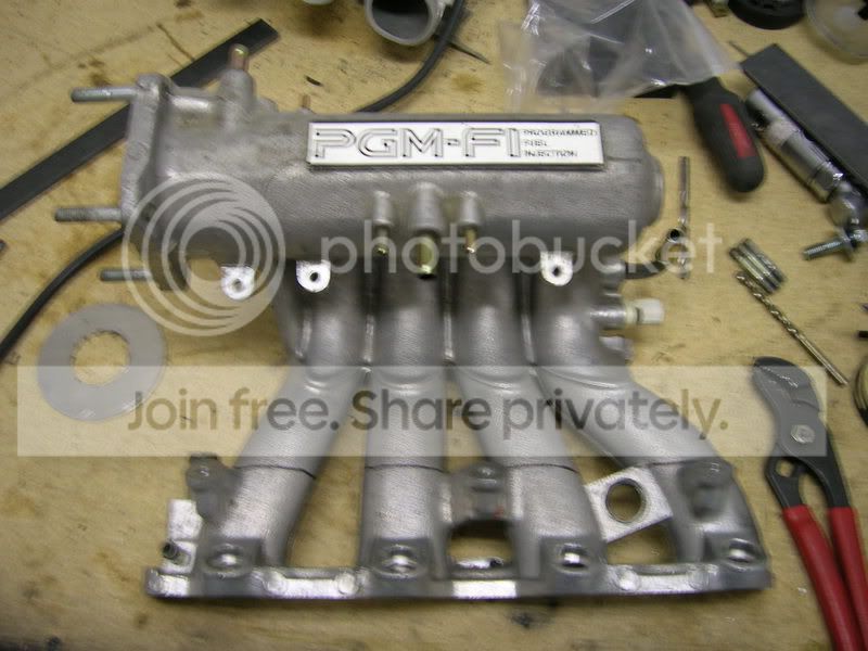

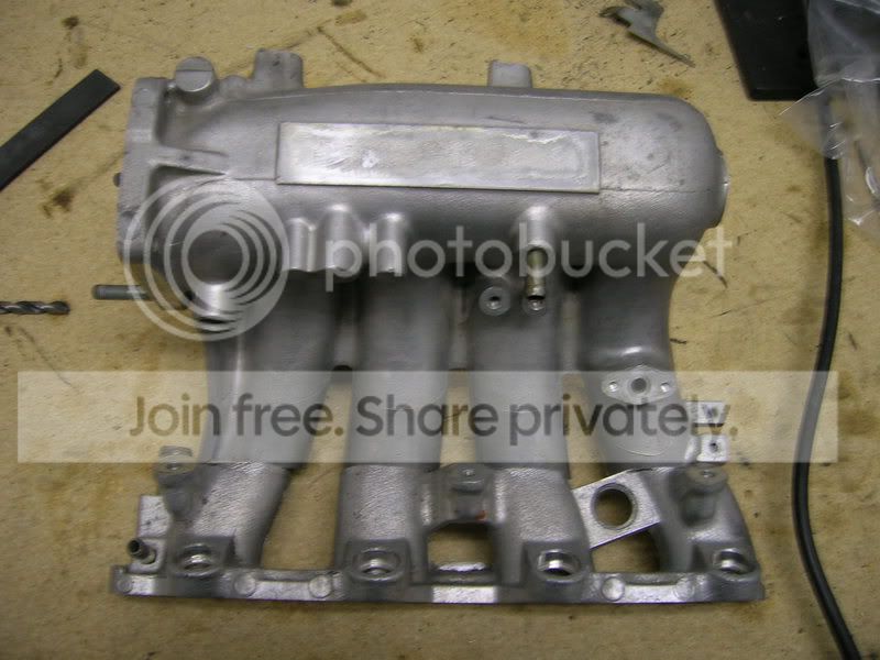

well i finally got some time to get the pics up....
stock D16A6 intake manifold
OBD 0 B16 intake plenum
fitment of B16 plenum on D16A6 runners
All finished up and welded
back side
ok no making fun of my aluminum welds first time welding anything major.. only done a few beads on some sheet i had lying around....
