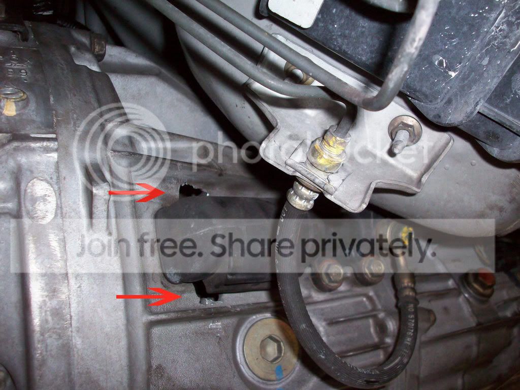

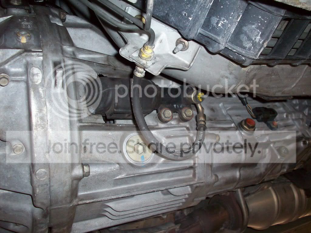

I was changing the transmission fluid in my recently purchased s2000 and I noticed someone had cut up around the slave. Why would someone do this? Everything seems to run fine, and I have been running the tranny pretty hard and everything drives fine. Any ideas? Thanks

my guess would be that the last owner cheaped out and tried to fit another car's slave onto it

when you change the clutch they want you to pull out the shift fork as much out as possible, but it wont fit through the hole.
looks like this guy put the tranny together after clutch install and realized at the last moment that the clutch fork was on wrong or something, so instead of pulling the tranny down again, he cut the hole to fix the problem.....

<TABLE WIDTH="90%" CELLSPACING=0 CELLPADDING=0 ALIGN=CENTER><TR><TD>Quote, originally posted by Oleg &raquo;</TD></TR><TR><TD CLASS="quote">when you change the clutch they want you to pull out the shift fork as much out as possible, but it wont fit through the hole.
looks like this guy put the tranny together after clutch install and realized at the last moment that the clutch fork was on wrong or something, so instead of pulling the tranny down again, he cut the hole to fix the problem.....</TD></TR></TABLE>
I concur.

those small holes are not going to hurt anything unless debris gets into the clutch housing. Other than that, it just looks horrible

yeah, not really worried about it, just curious. No one is going to see it anyway, and everything runs well.
