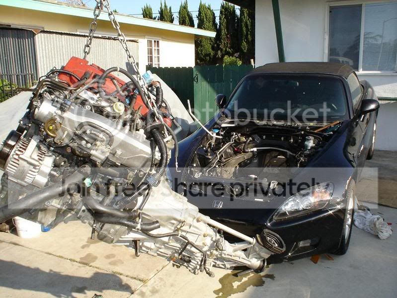

<TABLE WIDTH="90%" CELLSPACING=0 CELLPADDING=0 ALIGN=CENTER><TR><TD>Quote, originally posted by dkim48 &raquo;</TD></TR><TR><TD CLASS="quote">i bet it's the fork...a lot of people have problems with it. once you remove that it will fall apart very easily. good luck</TD></TR></TABLE>
x2 and thank you.
Modified by Mr. Projekt at 1:49 PM 1/4/2007
Old Jan 4, 2007 | 11:30 AM
JDM knowledge's Avatar
Posts: 8,884
Default Re: We need a crap load of help please (Mr. Projekt)
<TABLE WIDTH="90%" CELLSPACING=0 CELLPADDING=0 ALIGN=CENTER><TR><TD>Quote, originally posted by Mr. Projekt &raquo;</TD></TR><TR><TD CLASS="quote">x2 and thank you. BTW this picture is for that one guy that said you can't pull the tranny and motor as one, out of the car. Eat my shorts young man.
that is such a hurtful picture. Mortal Kombat-ish
