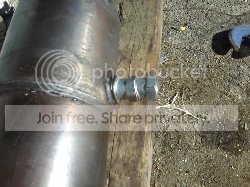

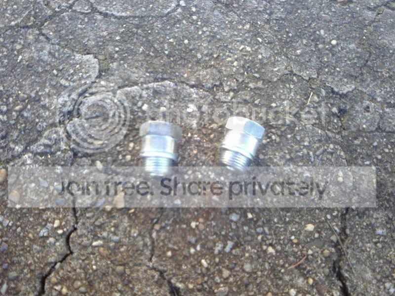

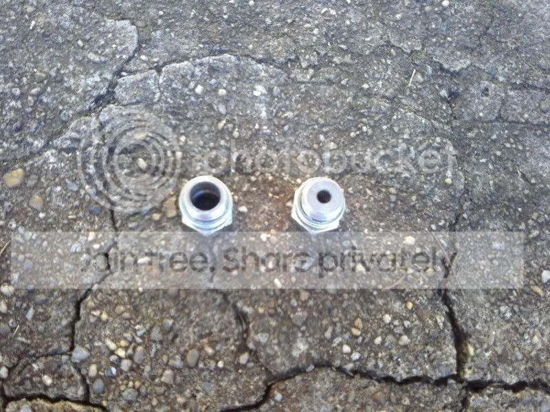

what I did was i gutted out my stock cat and made my own o2 fix. You just get two sparkplug nonfoulers i forget the size though' anyways you drill one out so the o2 sensor can screw into it. The you screw togather the two non foulers next u screw it into your testpipe and last you screw in your o2 sensor. This is what I did and it works like a charm.
This is the pic of the nonfoulers notice how one is drilled out.
