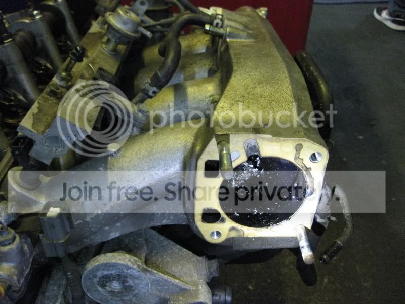

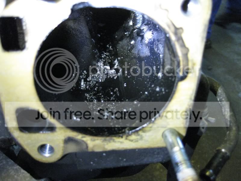

Ordered the engine from the UK about a month and a half ago, and it finally got here. I guess I had different understanding of "next day shipping", but I'll chalk that up to differences between UK and US English
So mechanic started switching the engines. Hopefully we'll take the old one apart soon and see wth exactly happened. The answer will have massive implications, as it will determine whether I'll be willing to ever buy a decent car again or not.
Looks like half a piston got coughed up through the intake manifold....
Old Nov 12, 2009 | 08:04 AM
SirStig's Avatar
Joined: Sep 2009
Posts: 171
Default Re: S2000 down
jeez.. at least you got the new motor. hope everything works well for ya
