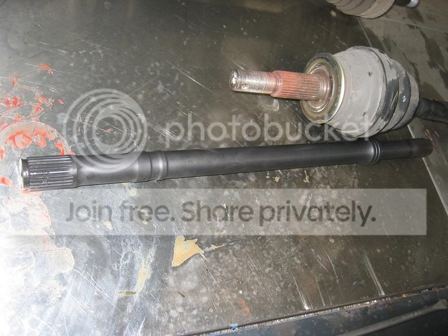

The axles are being spline and heat treated at the moment. I hopefully can test out the new setup this weekend

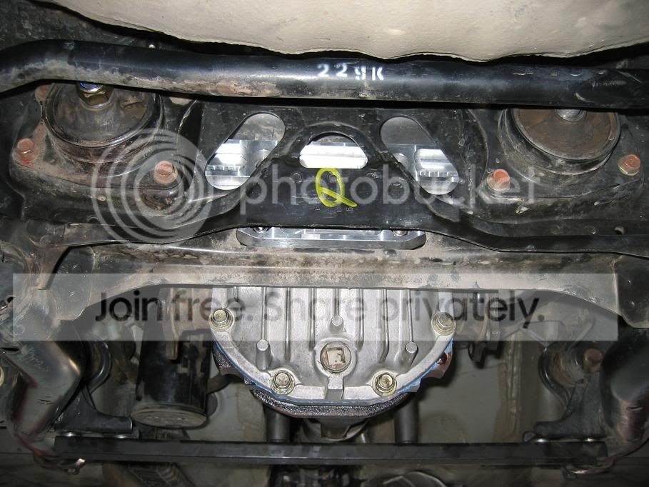

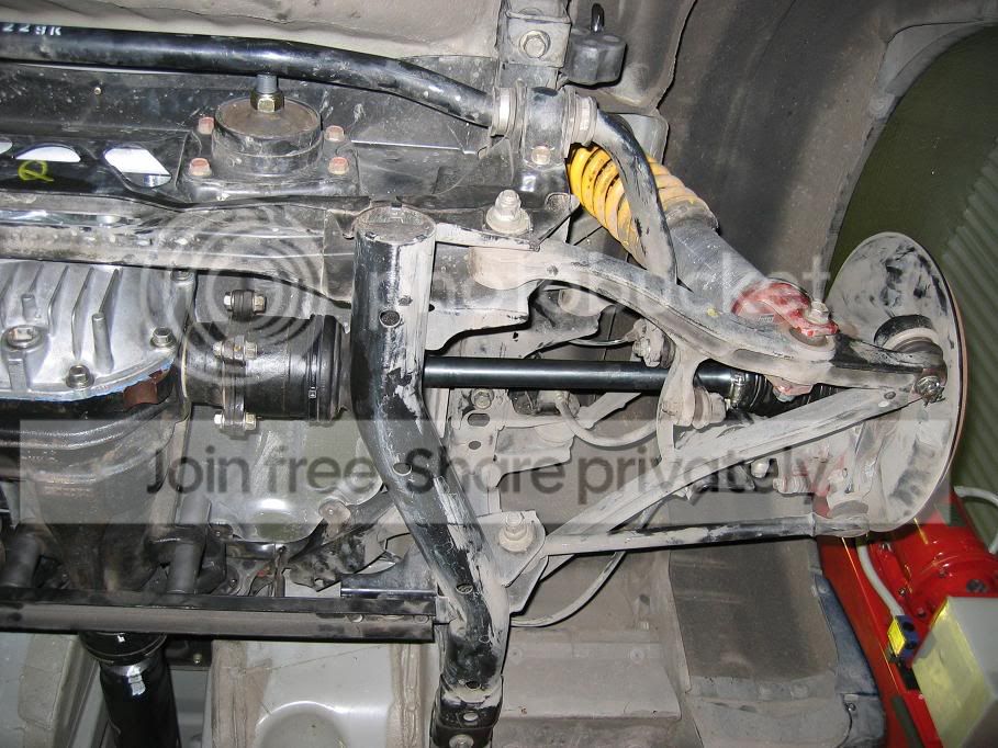

As you can see it's a very simple and carefully designed custom kit
The stock prop shaft and outer CV are untouched to retain their strength and reused for cost saving on the conversion. If they break, later on with too much power, then they can be easily upgraded.

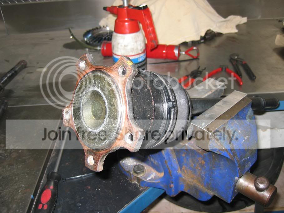

honda9krpm's Avatar
Posts: 188

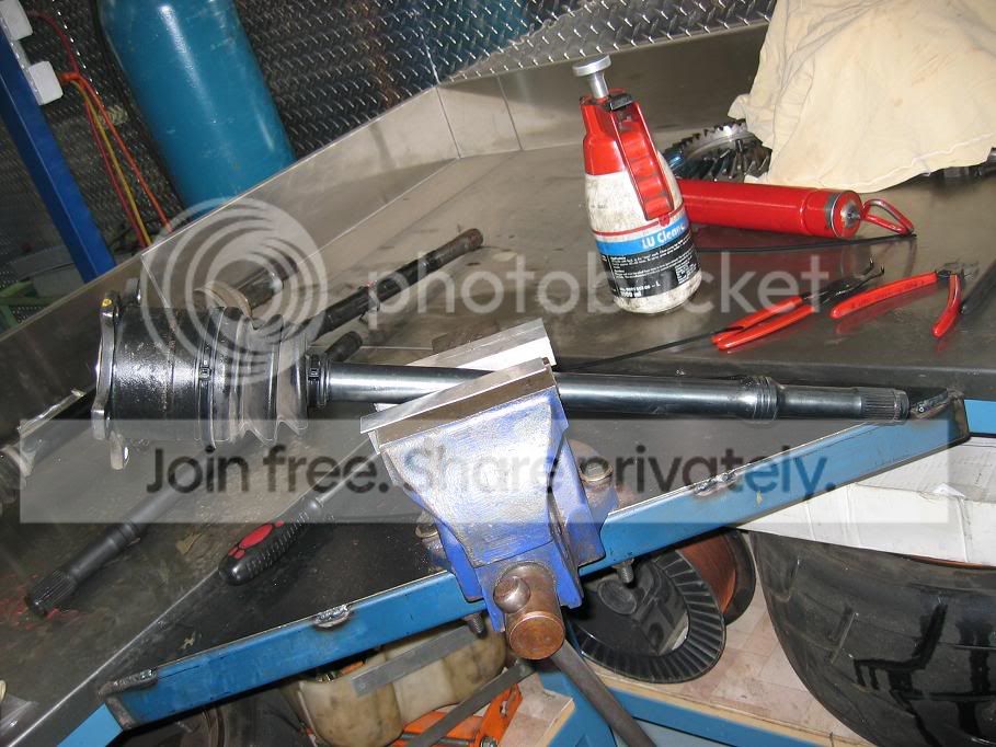

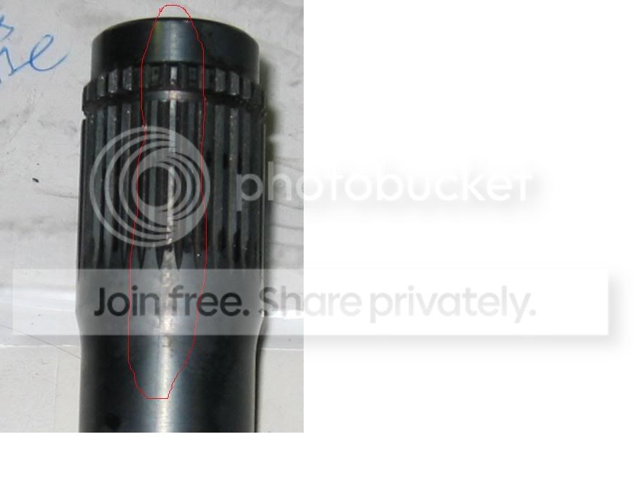

It's all done. However, when I blew my axle, I must have unloaded the gearbox and caused some damage. The gearbox is rattly and quiet when clutch pedal is engaged. Best scenario is stuffed input bearing, worst scenario is some missing teeth. So sorry guys, could not give it a proper test yet.
Here are some more pics
Heat treated axle
Nissan R33 GTSt inner cv joint
Right side done
Sorry I did not get a chance to take a picture when both sides were completed.

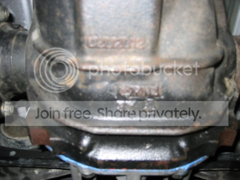

Diff parts number
Cracked axle after heat treatment. Faulty supplied material was blamed

<TABLE WIDTH="90%" CELLSPACING=0 CELLPADDING=0 ALIGN=CENTER><TR><TD>Quote, originally posted by honda9krpm &raquo;</TD></TR><TR><TD CLASS="quote">Mr Bagel, the currnent ratio is 4.1:1. </TD></TR></TABLE>
just being a stickler...
stock rear gear is 4.08 for a R200 in your application.
i love your project though. i have been tunignand building S13's and S14's for a few years now and have never really seen a rear end fail!! i like seeing this type of ingenuity!

OK here is a run down of what I think is included in the kit
(There may be more or less depending on the distributor)
1. Rear mouting bracket for the diff
2. Front mounting bracket
3. A custom made front snout/flange (or what ever it is called). It replaces the front flange of the s13 diff and hook up directly to the s2k prop shaft
4. 2 custom axles that fits directly into the s2k outer cv and the inner R33GTSt cv joints. I think the workshop also took down measurement for a S13 inner CV joint.
5. other nut, bolts, cv boots, brits bracs etc etc for a plug and play setup for any home mechanics.
The kit is really simple and carefully engineered. The materials are of high quality and made from CNC, splining and heat treatement machines.
