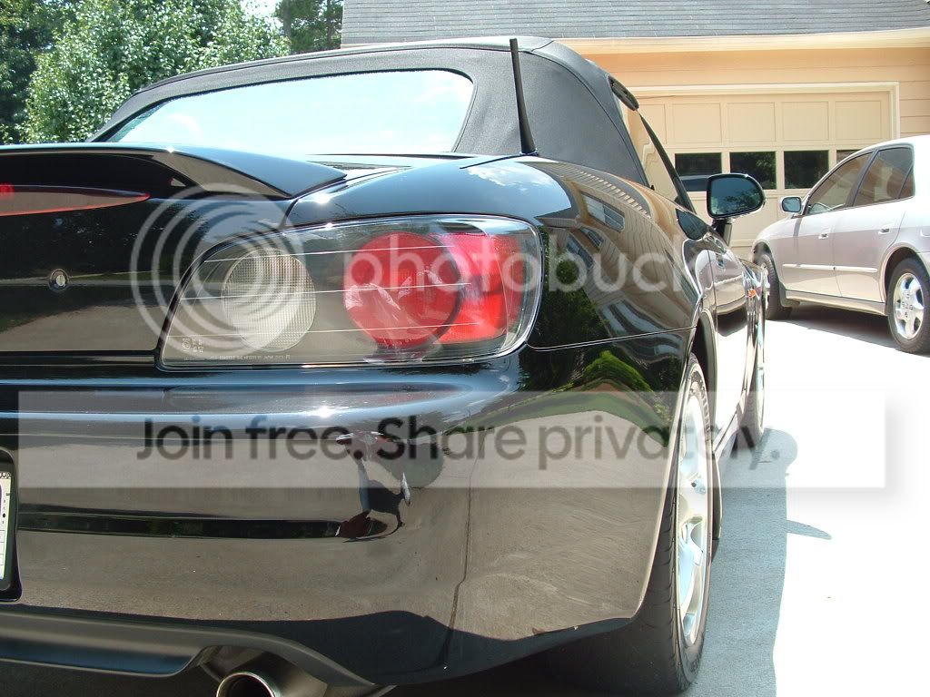

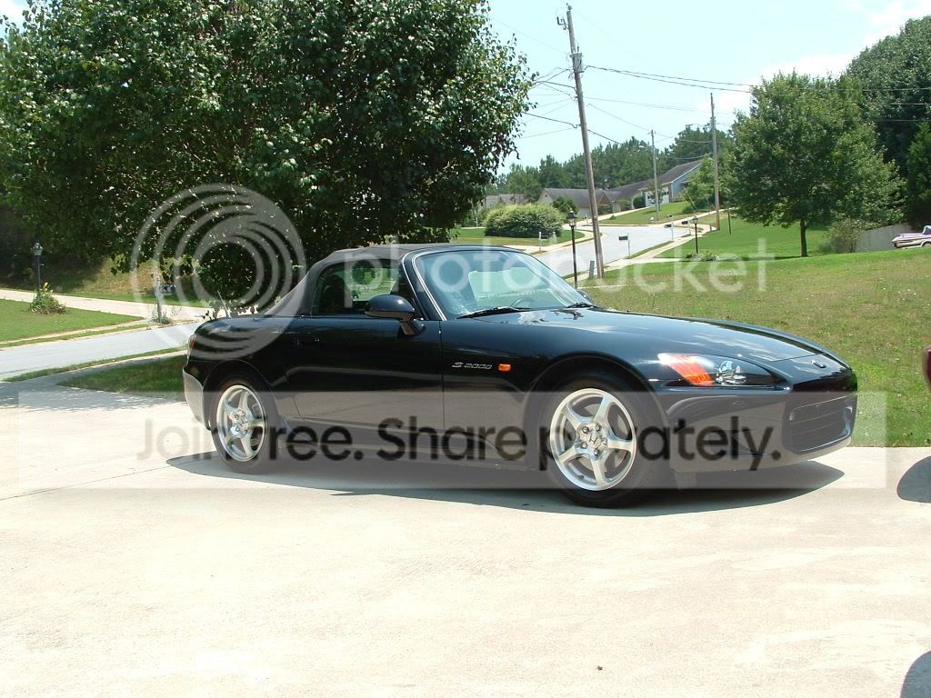

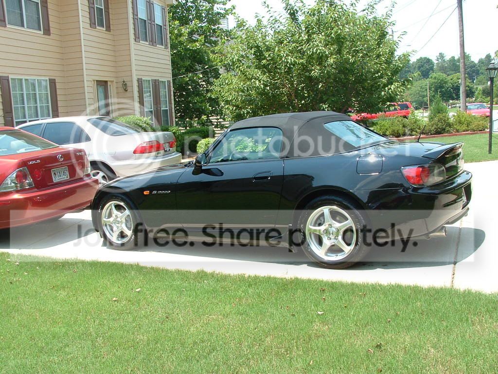

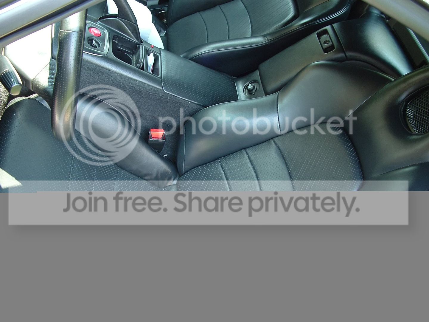

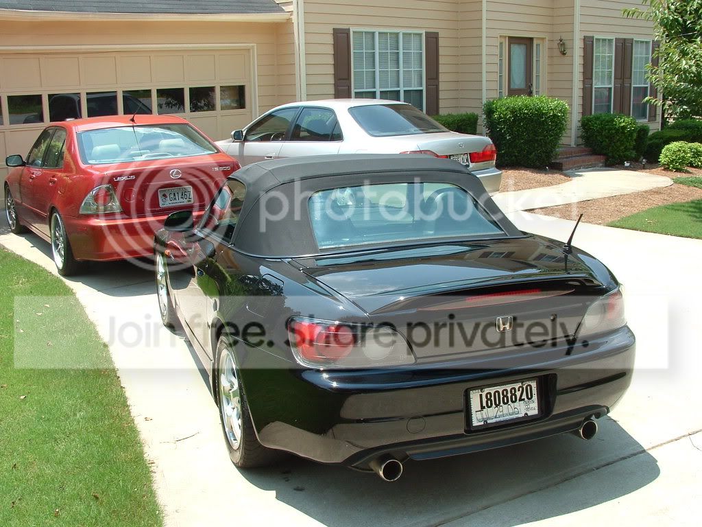

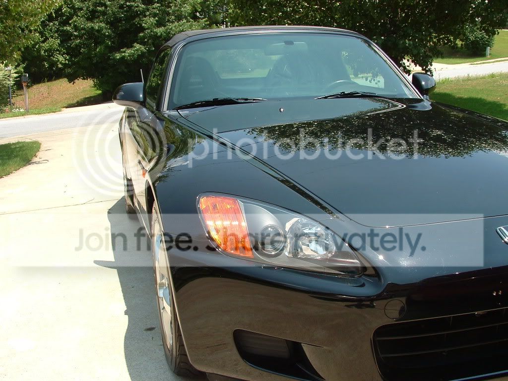

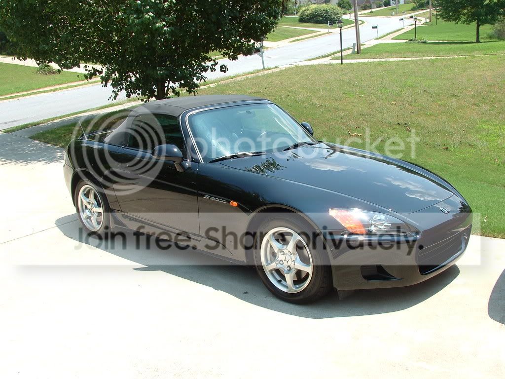

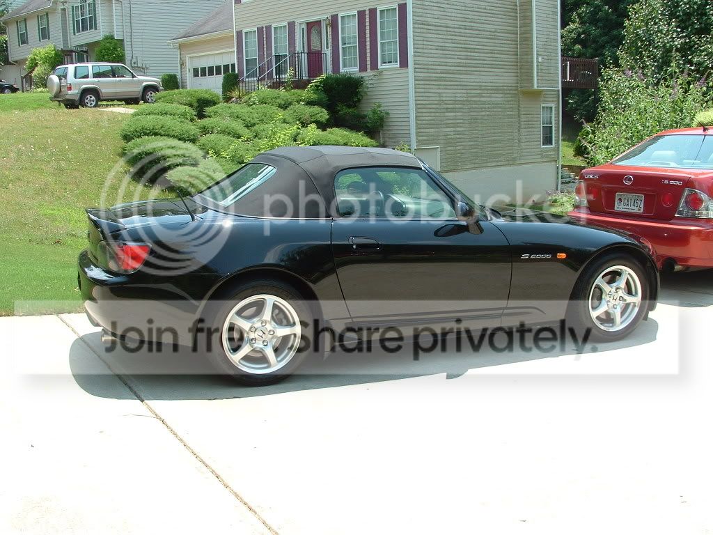

Swapped the balasts and determined that one was bad. Will have replaced by Monday. Thanks guys. As promised, here are some pics. Will do a photoshoot later next week. Heres some for now.
PICS MAY BE SLOW TO LOAD...

it looks like mine without a lip

congrats of the purchase man
looks nice n clean
