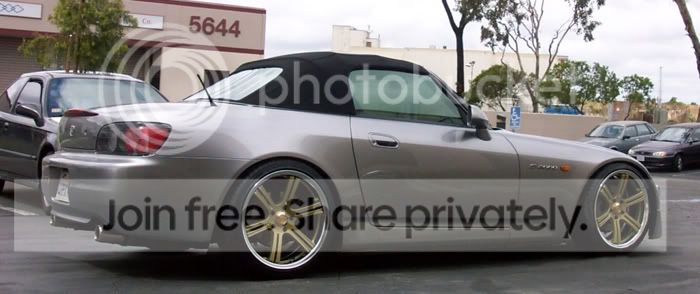

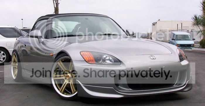

Our customers car.
18x9.5, 18x8.5 + 40 all around.
215 up front. 245 in the rear. Rolled Rear Fenders
Modified by OBSeRiouso at 6:39 PM 5/14/2006

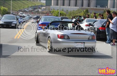

Re: Enkei RPF1 info request... (OBSeRiouso)
<TABLE WIDTH="90%" CELLSPACING=0 CELLPADDING=0 ALIGN=CENTER><TR><TD>Quote, originally posted by FR-MOB: Projekt »</TD></TR><TR><TD CLASS="quote">Running a narrower tire and you usually do. Like putting 245s on a 9" wide wheel. A waste if you ask me, plus there's less protection for the wheel.</TD></TR></TABLE>
Projekt is correct though. The stretched tire look is more for aesthetic reasons. You WILL lose contact patch but i think it looks hard as a mother *****. haha.
I personally like the stretched look. If you see in that pic from the eibach meet, the tires on the silverstone cave in so it doesn't hit the fender. Usually for clearance/Looks. Kinda like this....
Stretched = ( ) ( ) Vs Regualar [ ] [ ]
Modified by OBSeRiouso at 11:27 PM 5/14/2006
