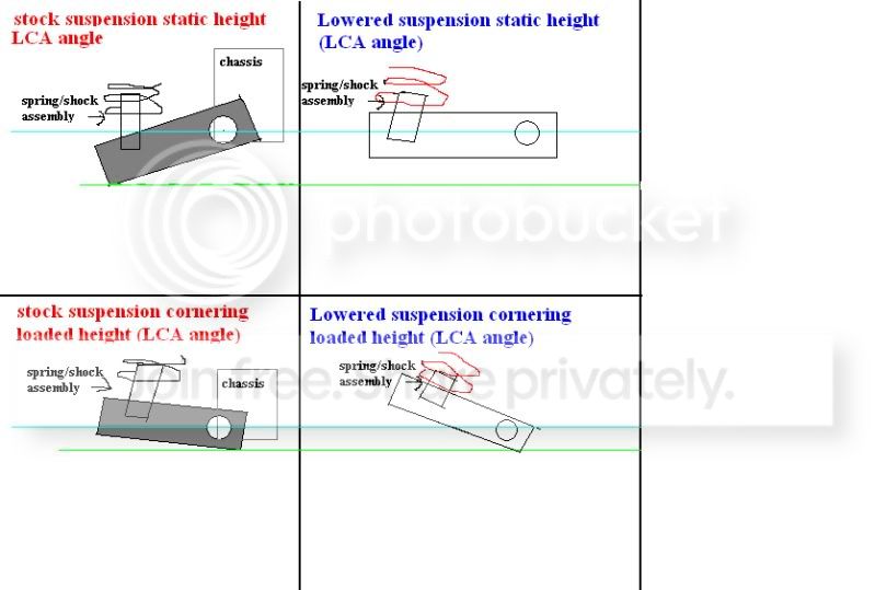

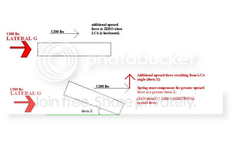

It's a bit of a read, but I can justify what I said.
I think you're misconstruing what I said. I didn't say stiffer springs increase body roll. However, roll centers are an important facet in automotive engineering. Lowering a car can create upward angles on LCAs. If G-force is acting directly perpendicular to the face of your wheel (it is), then adding an upward angle on the LCA will make it easier to push the spring upward. The sideways force from Lateral acceleration combined with an upward LCA angle will push the spring/shock combo upwards.
This is demonstrated here in my cave drawings (Imagine you're looking at the LCA directly from the front or rear of the car):
OBVIOUSLY, the angles are exxagerated and made up. But this is a good demonstration of what actually happens to your LCA. Here's the issue with the upward angle:
So basically to put numbers to it...if you had a force of 1200lbs pushing at the wheel (resulting from lateral acceleration) and the LCA was flat...none of that 1200lb force would translate upwards into the spring/shock.
Now if you had the same 1200lbs with a LCA angle of 10 degrees (theta X = 10), and you go through the equation in the diagram, you get an "extra" upward force of 211.6lbs. This means that additional to the body roll that is already occuring you get 211.6lbs of force compressing the spring/shock. The larger the angle the larger the upward force. The smaller the angle, the smaller the upward force.
When theta X is 5 degrees, the extra upward force is 104.98lbs
When theta X is 20 degrees, the extra upward force is 436.76lbs.
The further you get away from horizontal, the more the lateral force will translate into upward force. The LCA acts as a lever to push up the spring.
This is easily demonstrated by putting a 2X4 up against a wall. Put it completely horizontal to the wall. Push as hard as you can to push the 2X4 into the wall. If the wall is sturdy, the 2x4 won't move.
Put an upward angle on the 2x4. Push on it now. It will pivot into the wall much easier.
So...back to the car example...you get more body roll unless the spring can compensate. The way the spring compensates is to be stiff enough to push back that extra upward force. The problem with MOST lowering springs is that they're soft in order to be used with stock shocks. They're either too low to be that soft or too soft to be that low.
Here's a likely scenario: Lateral force builds quickly at first causing the car to roll and causing the LCA to go further and further up. Then the lever arm action created by the LCA being pointed upwards makes the spring artificially "softer". The car body rolls more and more till it stops creating lateral force.
I also said that there are SOME lowering springs more suited for the track. Combining your Eibach sportlines that only have a 1'' drop with a more agressive alignment and better tires would net you better lap times.
You're also a little off by saying that a stock S2000 couldn't hold a 1G corner. With a turn of that radius and sticky tires...it definately could. A stock AP1 does around .92-95G from tests I've seen. The stock CR does around .95-.97G from what I've seen. The AP2 did worse because of it's dismally bad factory tires...IIRC, it was like .89G or so. The AP1/CR have better tires from the factory and are pretty damn close to 1G in absolutely stock form. Add stickier tires and BAM...1G wouldn't really be an issue.
You're also basing your 1G measure from an iPhone app. There's a little room for error there, I would imagine.
Yes, like it SHOULD.
On cornering, the weight transfers to the outside edge, pushing the LCA into the angle you've exaggerated, and pushing the side of the vehicle upwards... to prevent additional body roll:
http://www.youtube.com/watch?v=cfddsOd3jgE
Notice in this video at 1:10, he takes a right turn, where the LCA's are pointed upwards... yep, to help keep the chassis off the tires and keep the tires in contact with the road surface. Which is what it's suppose to do.
And now you see my whole point. I didn't recommend crap springs.
didn't say a stock S2K couldn't... I said if the springs were WORSE than stock, it might be a difficult task, especially if they were stumbling all over themselves, rolling over the tires to insanely crazy body roll, etc, etc.
The GPS lap timer was within 0.1sec of AMB transponders, and the accelerometer in the iPhone has for more engineering, testing, and reliable data than your pretty MS Paint drawings
As a general sweeping statement, springs/shocks probably wouldn't outperform even cheap coilovers in a track environment. There are, ofcourse, exceptions to this rule...but I'm speaking in general.
As a general sweeping statement, most coilover users will never have their suspension properly tuned to see the benefits of having coilovers.
