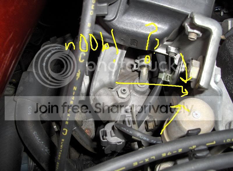

I have that same exact leak and after removing the tranny and doing a lot of inspection it appears to be coming from the 'shift arm cover'....number 6 in this picture---.
There are a few oil seals and such in there that I plan to replace in the future...maybe that's where your leak is also because it's DEFINATELY not axle grease...

^^That area is relatively clean, Im wondering if the cam seal could be to blame for the oil residue. There is oil residue where the yellow arrows are pointing.

that cam seal is known to leak, get an aftermarket multi o-ring seal
