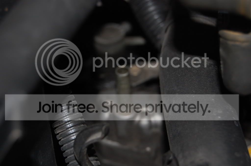

so me and my friend were bleeding his clutch cuz his resvoir is leakin somewhere and it ran out of fluid so it had air bubbles,, while lookin for the leak we came across this and jus were curious wat it is.

it looks like a hose or somethin goes on it but i stuck a screw driver in it and theres somethin blockin it.

its the breather for the transmission. a little rubber cap is supposed to be on it but it really doesnt matter mine is open too

I would at least roll up a piece of paper towel and stuff it in there. Any dirt or grit you get in there goes through your gears and bearings. And since there's no filter on the transmission oil, it goes through the gears over and over.

<TABLE WIDTH="90%" CELLSPACING=0 CELLPADDING=0 ALIGN=CENTER><TR><TD>Quote, originally posted by flyrod &raquo;</TD></TR><TR><TD CLASS="quote">I would at least roll up a piece of paper towel and stuff it in there. Any dirt or grit you get in there goes through your gears and bearings. And since there's no filter on the transmission oil, it goes through the gears over and over.
A rolled up piece of paper towel is just as bad as dirt when it makes it way down into the transmission.

wrap a piece of screen around it and ziptie...just dont block it off, the pressure in the trans will push oil out instead of air

Well, don't stuff it into the transmission. Just plug the vent with it, and leave enough hanging out so you can remove the plug to change the oil. It will still let air through but will keep the dirt out. Mine's been in place for the last 50k miles.
