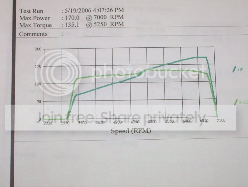

here are my dyno sheets
before
now with type s cams
I got tuned in like late july last summer when it was preaty humid its preaty dry and cool here still

high compression pistons are key to getting power out of higher/longer lift cams. you still should have made some power since stock pistons aren't really low compression pistons. i know a guy that got cams for his b18c1 and lost about 10 whp, then he got pistons and made like 25whp (+15 whp from his stock internals setup). and these figures are without ANY kind of tuning, just dyno runs to see what kind of power he was making.

Im looking in to getting a hi compression headgasket trying to figure out what the ratio whould be with a .032 gasket
